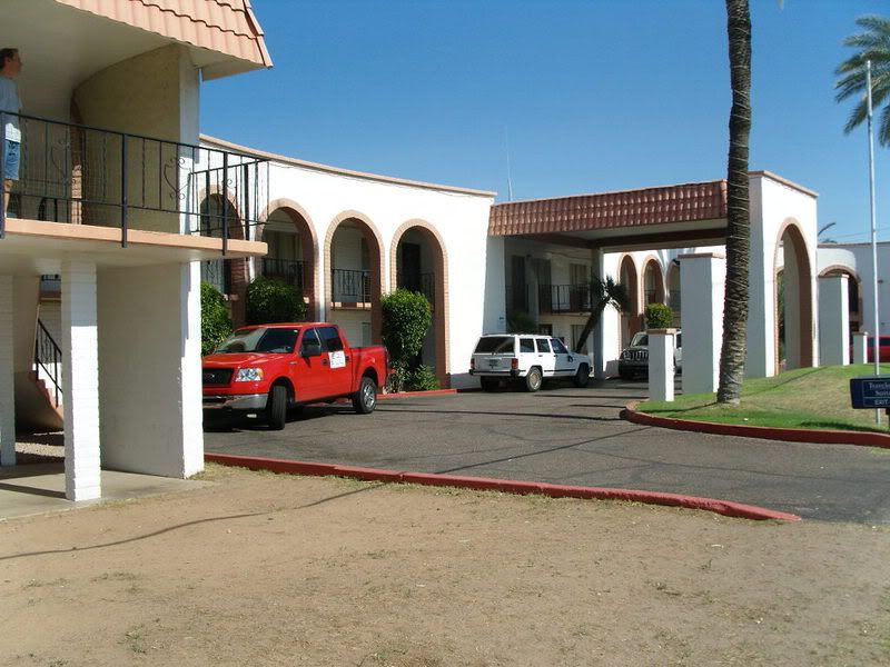

Nice from far, but far from nice-:)

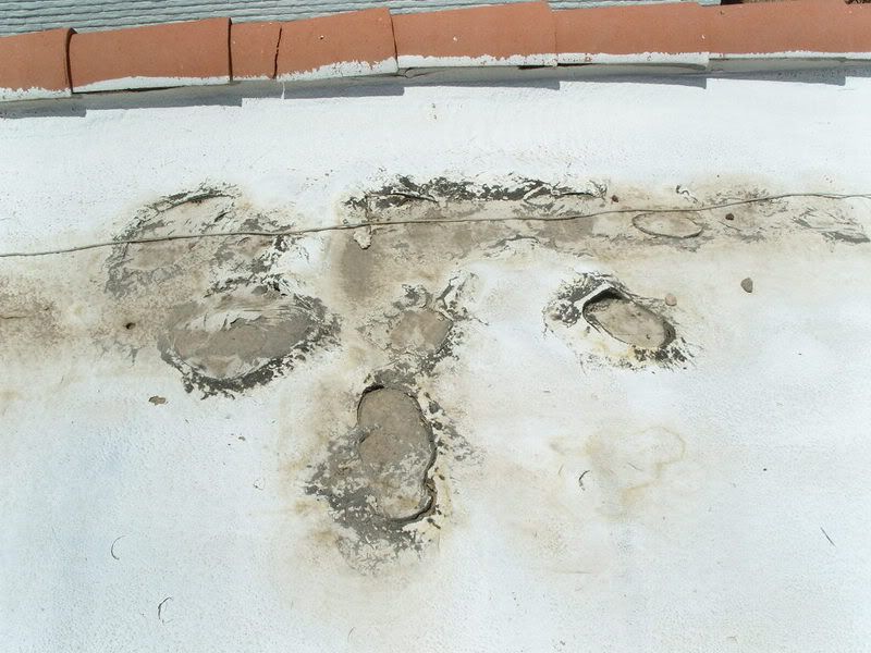

One third of the roof.
http://i74.photobucket.com/albums/i247/badstucco1/TravelodgePhoenix047.jpg
Foam over torched-down.
http://i74.photobucket.com/albums/i247/badstucco1/TravelodgePhoenix042.jpg
Clay Tile Cap at Parapet.
http://i74.photobucket.com/albums/i247/badstucco1/TravelodgePhoenix012.jpg
Repairs of this nature needed over the entire roof.
http://i74.photobucket.com/albums/i247/badstucco1/TravelodgePhoenix054.jpg
http://i74.photobucket.com/albums/i247/badstucco1/TravelodgePhoenix055.jpg
The framing & plywood has some issues also–:))…Walk slowly-:))

Dale,
are those termite tubes in the last photo?
Nice…
Yup…those are Termite tubes. You’ve got a pretty good infestation going on there.
