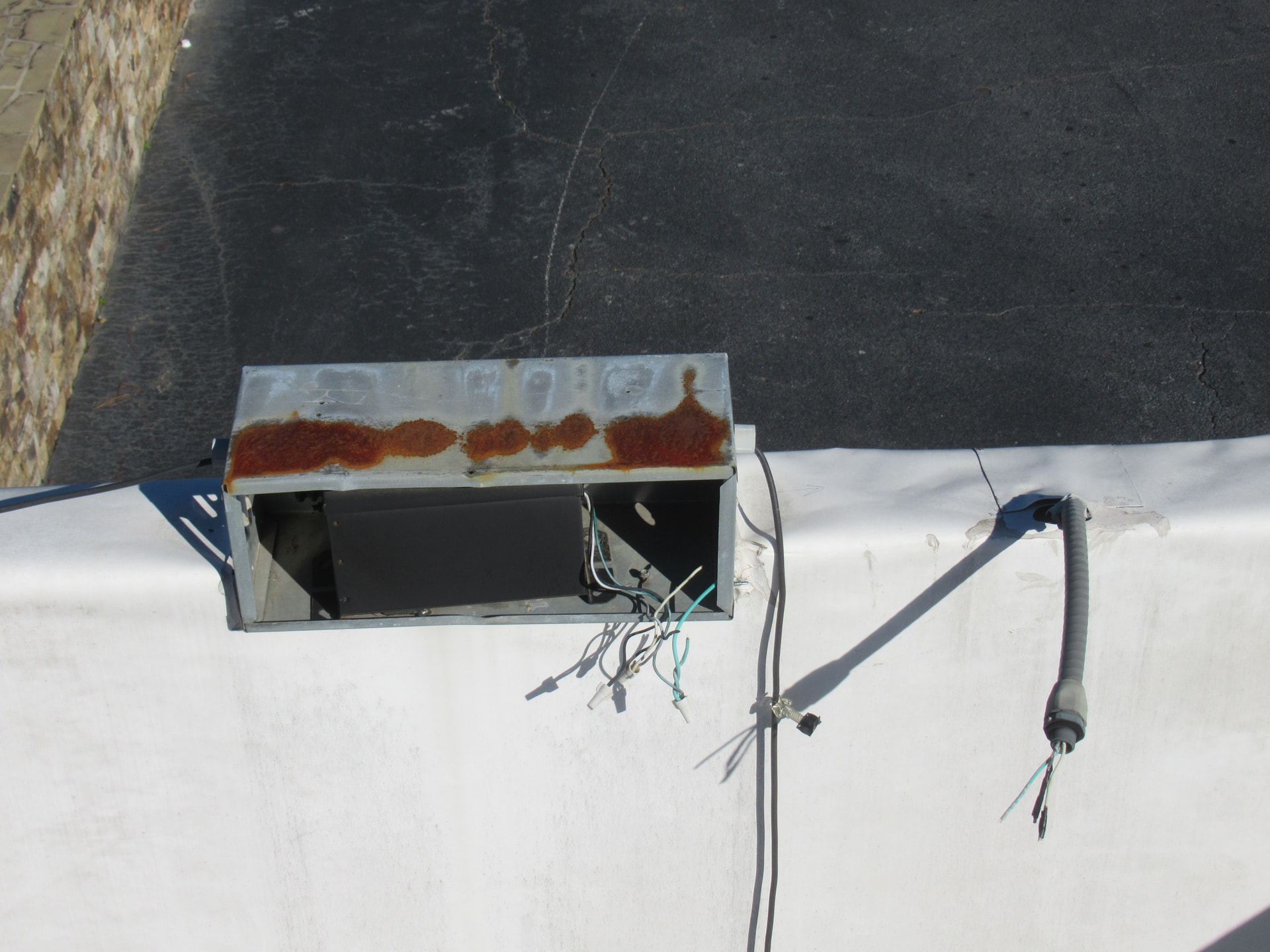

Today’s commercial inspection near Atlanta GA. Pizza restaurant. Built in 70’s. Roof covering only about 11 years old.

Fired chicken rooftops, lol. It that the one where we found the slab foundation and wall issues on the corner in the dinning room?
If so, those are some good pics to post if you have any of that wall and foundation issue. At first look you wouldn’t think much of it. But after piecingthe puzzle togther and a deeper dive, it revealed a much more significant issue. On the inside there was no visible cracking in the dinning room. Inspecting above the ceiling tiles the wood wall framing had separation, settlement and movement. Then looking visually you could see sloping at the window header and floor. The exterior sidealk did have some cracking and settlement in that area.
Many inspectors do not remove ceiling tiles. I’m a big fan of inspecting above ceiling tiles if it is possible. There are always issues above those ceiling tiles. Sometimes you can’t get up there, but if you able, I recommend always doing it.
