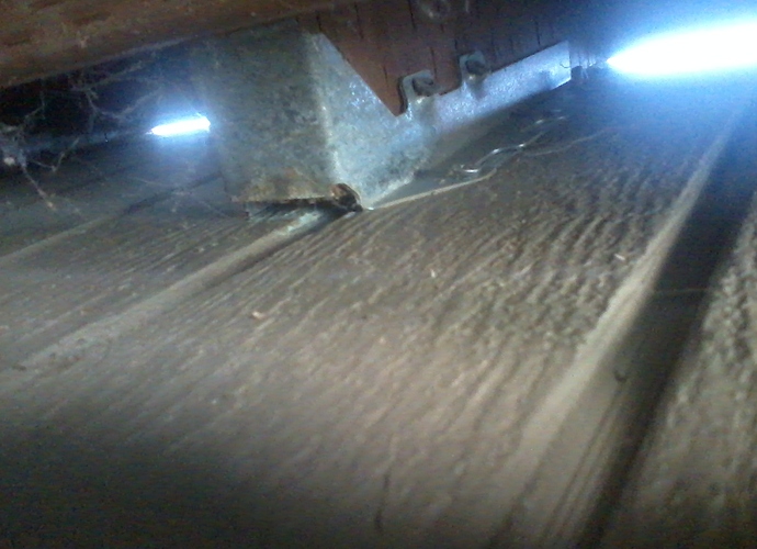

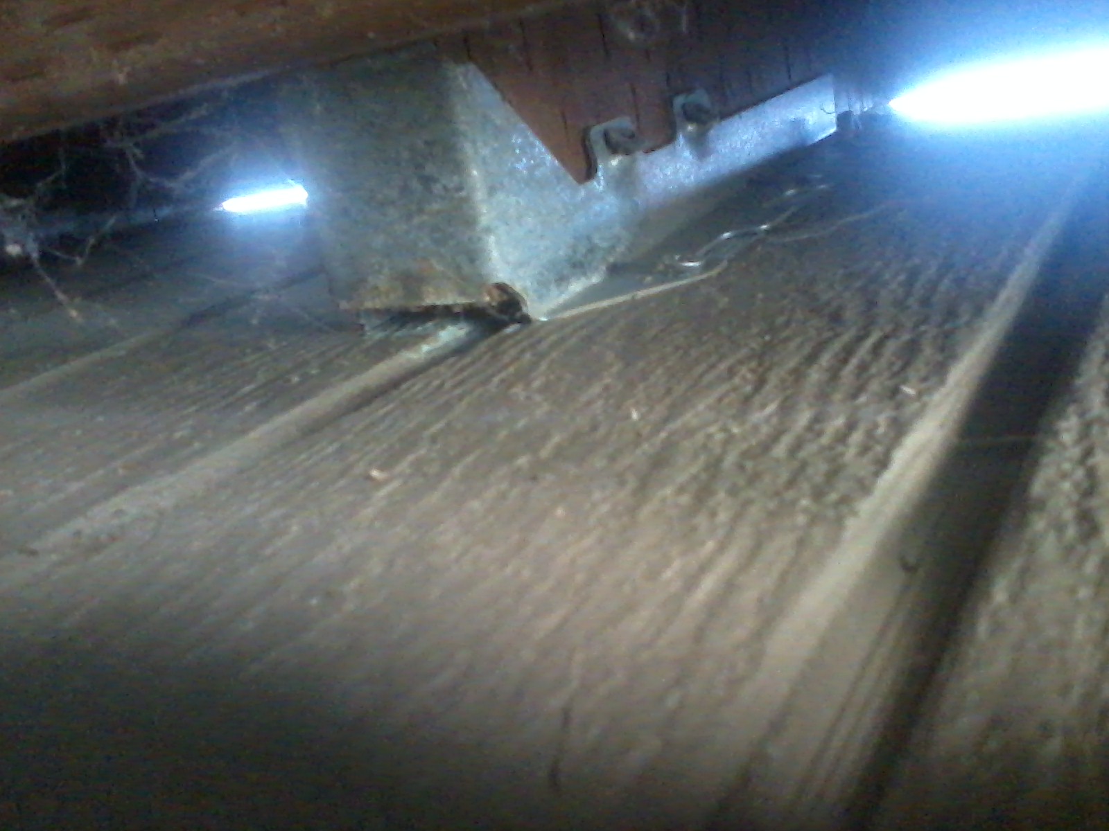

No Ledger
No Ledger!
Deck? have a hot tub on it?
It’s PT lumber attached to exterior grade siding. Guess no flashing is required either.
You also have screws in the joist hangers.
