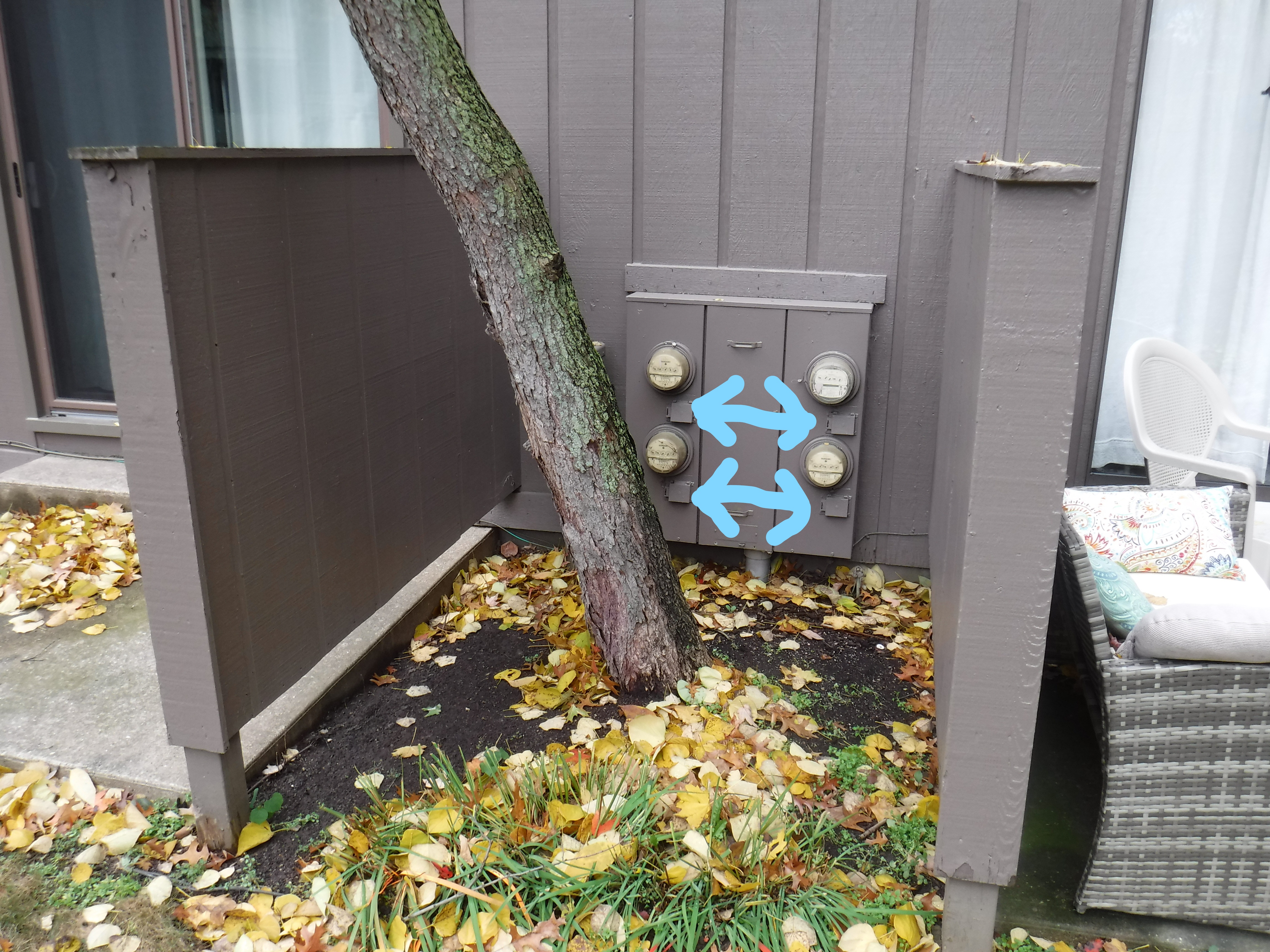

Simon, I appreciate the help. I have another inspection close to this one tomorrow. I will stop by and take another peak. Any chance it could be connected to the other attached townhouse?
Typically, the OCPD protecting the feeder feeding power to the subpanel in your pic must be next to the meter, you cannot have a long run of exposed feeder that is not protected by OCPD.
The meter is on the outside of the other side of the garage

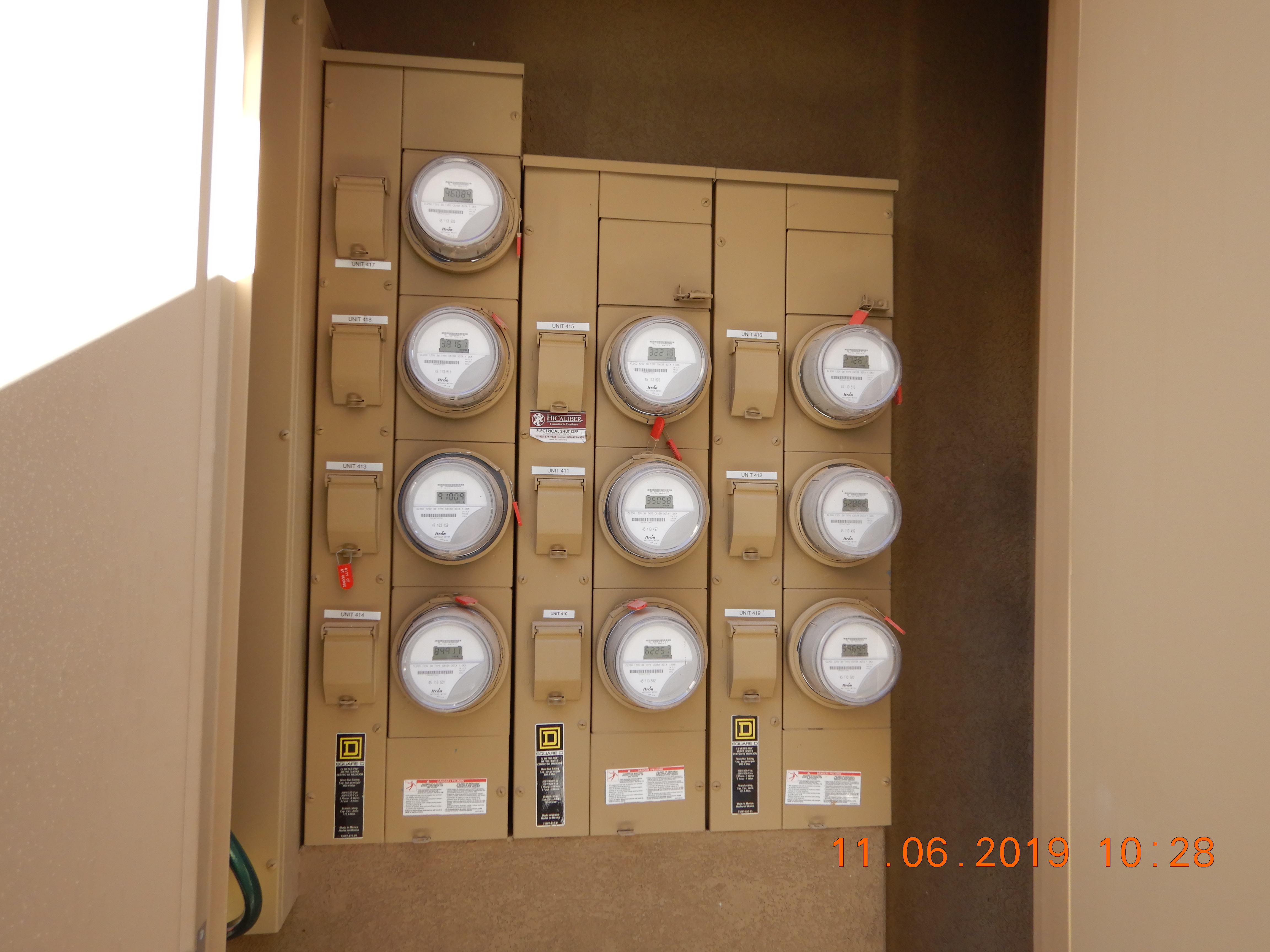

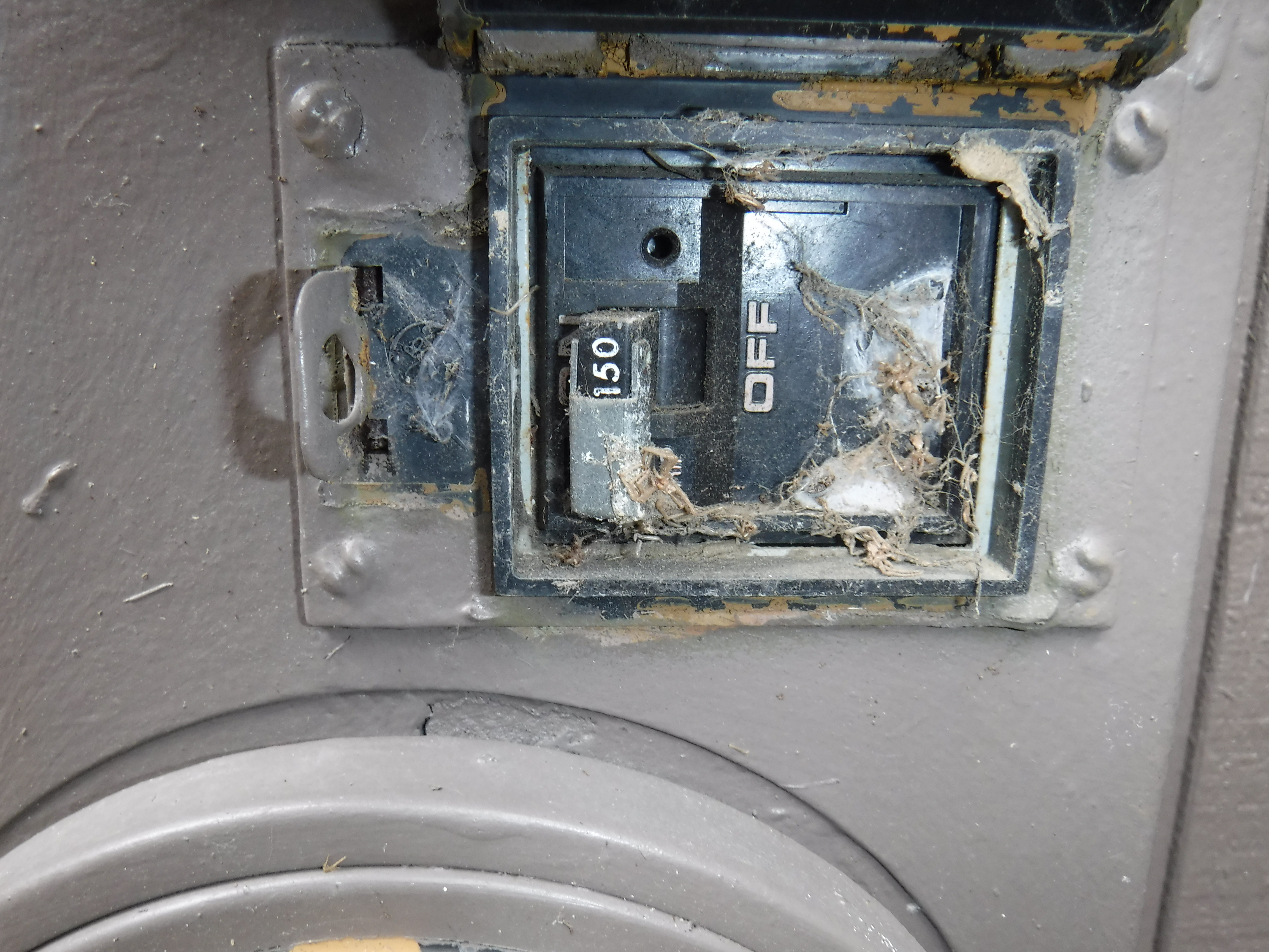

John, in the pictures provided look for square covers or something similar at the meters. These will be covering the disconnect.
On a Townhouse or Condo the Service Disconnect (Main Breaker) is almost Always going to be in a remote location and not in the Panel you find in the Home.
Reason? Because you do not want hundreds of feet of Unfused (unprotected) conductors running through the building, especially running through possibly other units in the complex. Even on Single Family Homes the length of those unprotected conductors should be kept to a minimum between Meter and Main Breaker.
I just did a condo yesterday and I really had to search for the meters and Main Breaker. It was in an outside enclosure (Closet) at the east end of the complex. The unit I was inspecting was in the middle, on top floor.

Did you look on the other side of the wall where the meter is located? As others have stated once the service entrance conductors (SEC’s) enter the structure there needs to be service disconnect and an OCPD. If the SEC’s were run on the outside of the structure then their permitted length is unlimited.

Thank you all for the information. I did go back to the property and yes I missed it. It was in a panel next to the meter.
