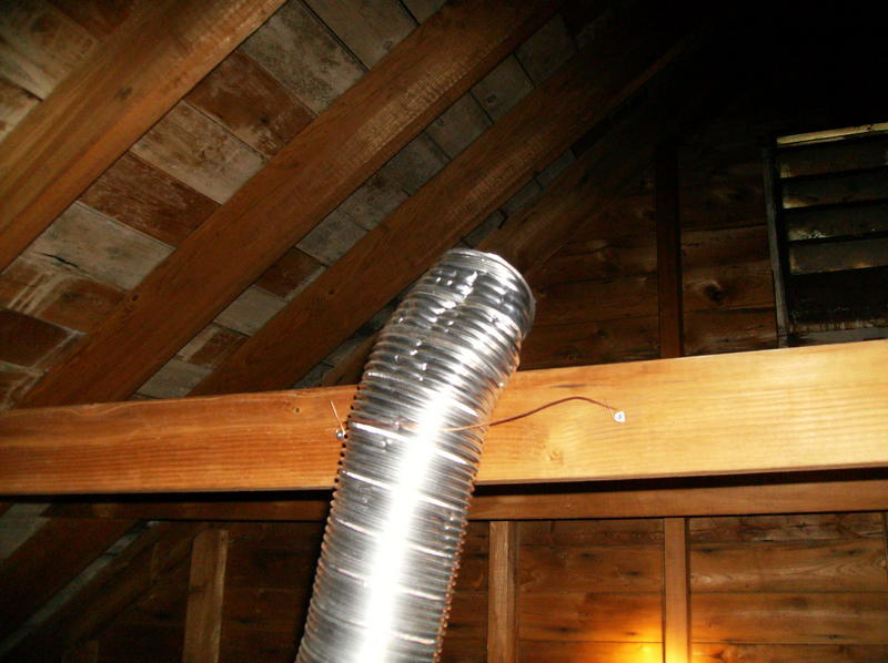

Handyman special on the bathroom exhaust. Just cut into the nearest wire, and wire the flex vent to a collar tie. No problem!:shock:

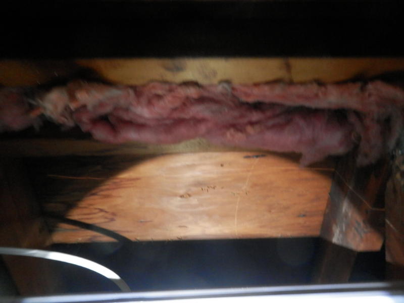

additional Attic insulation installed …

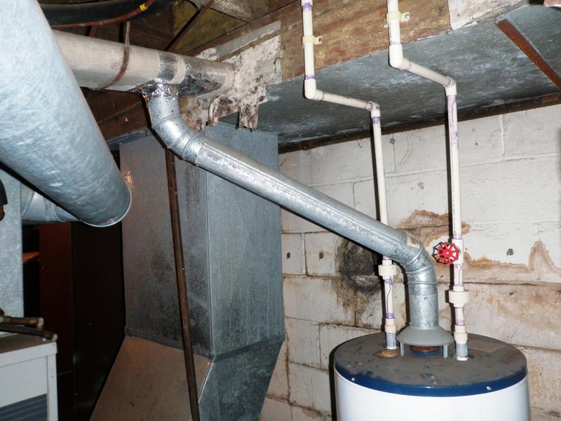

Water flue vent connected to transite duct then passing through HVAC return air. :shock:

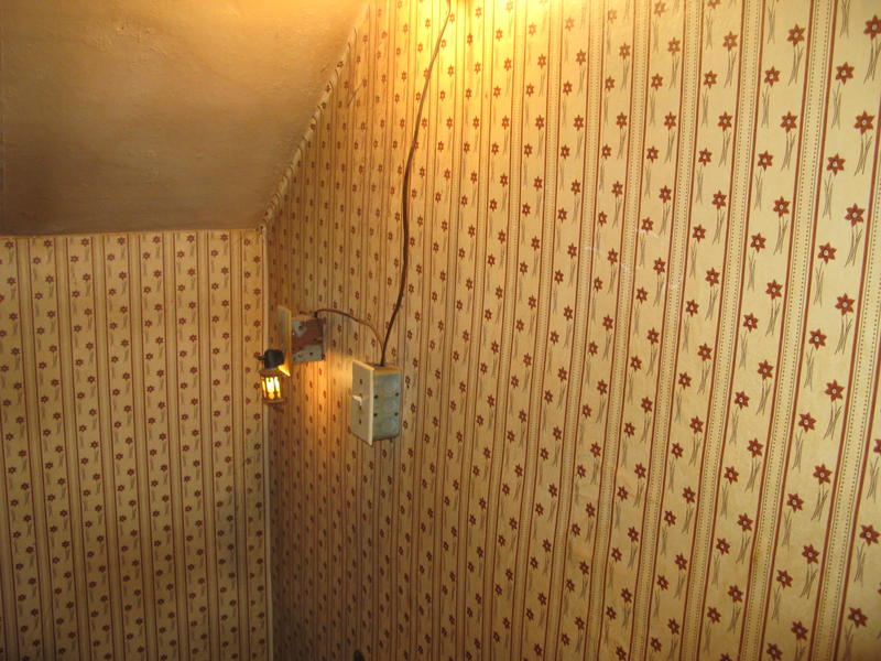

I wish there was a contest for whole house defects! This home would be a contender. The wiring in this house was a major safety hazard. This is only one of many locations. Basically the switch going up from the receptacle turns off the receptacle itself. The hallway light is plugged into that receptacle, goes through the wall and the connections put together with electrical tape. The switch at the bedroom light turns off the light. The wiring is all knob and tube but the knobs and tubes are missing in this area of the home. The buyer was told that the box and wiring was new. The panel and about 5 feet of each wire was new, then spliced together with marrettes into the K & T with no junction boxes.

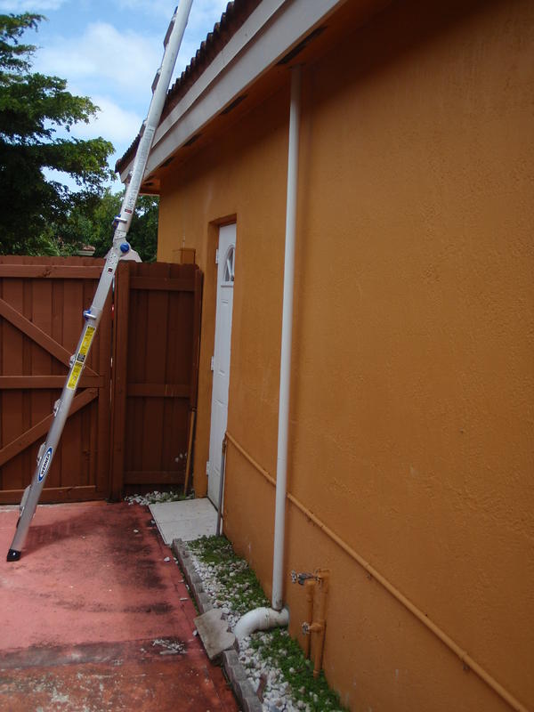

Gotta love D.I.Y.ers. Here’s the solution for when you forget to vent the waste line on an added bathroom in the garage. Not to mention it’s venting into the attic.
And it did actually work.
