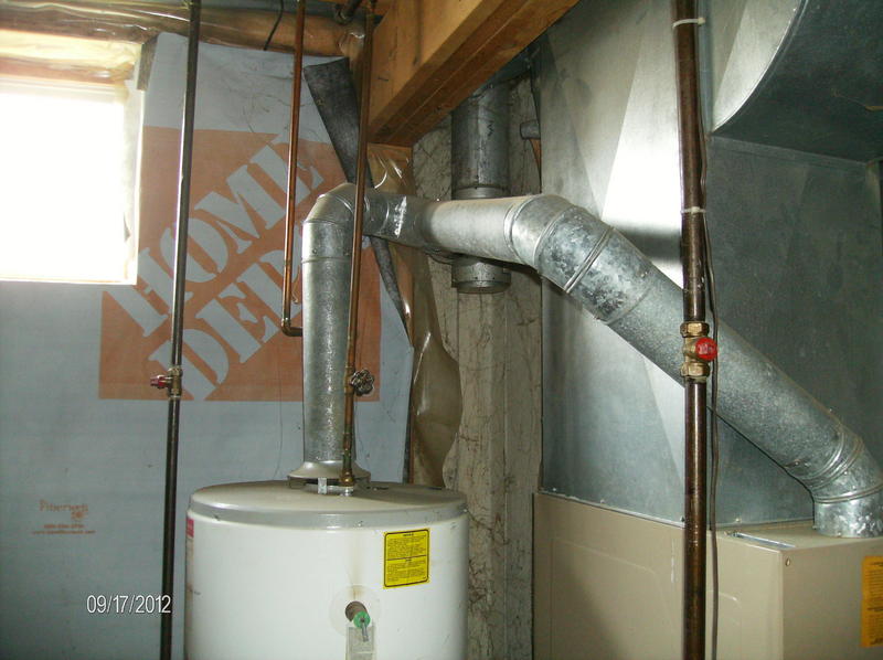

Couple of issues with this setup. Downward slope of HWV into shared “Y” with furnace. Both gas shutoff handles removed.
Are cobwebs flammable? ;):slight_smile:
A multi-purpose coverplate…
Marcel, what is that abortion? Can you elaborate, never seen a mess like it yet. :slight_smile:
WTF? :shock: Get’s my vote for December!

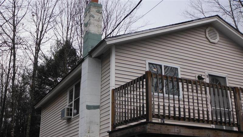

Service entry cable in contact with the roof.
That chimney don’t look to good either Pete. :wink:
I know, take your pick with those pictures.

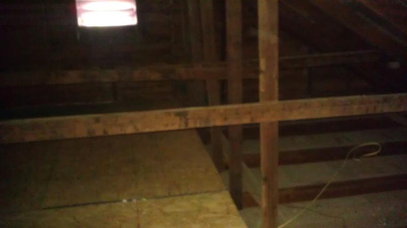

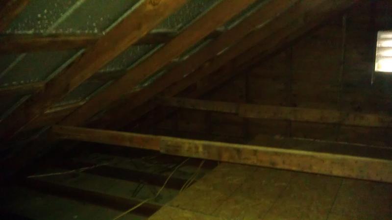

Termite remediation…Remove rafter and collar ties. Add a couple of 2x4’s Wait for big wind and collect insurance. Oh you paid cash in that case I recommend further evaluation by a G.C. who specializes in residential framing.
