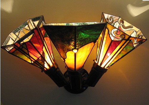

I heavily doubt those sconces are rated for damp locations.
Maybe designing light fixtures and neon jaded me, but I consider that a bad location unless the are wet rated.The only type I would accept are like you see outside with a dome type shade(globe).
Using hanging from the ceiling “only” as a guide means you would accept this…below.
I get it Bob, but the fact remains, there is nothing that prohibits that installation. As Marcel pointed out, even GFCI protection is not required for these lights, unless it’s required by the manufacturer.
So then what about this one? I called it Unsafe in the report. It was not GFCI Protected (along with the ungrounded, unprotected receptacle at the bottom of the wall next to the tub.

That lighting fixture is certainly not listed for that location. However, the receptacle location is perfectly acceptable as long as this is not a manufactured home. Being ungrounded and without GFCI protection are the only issues requiring correction.
Knowing “what” to say and “how” to say it is a skill within itself, but if you intend to make recommendations that are not “code-based,” you need to rethink the “how.” This is not “how.”
Your implication is that this is an"improper" installation, when in fact, it is not.
Stating something like - *I/we recommend removal or relocation of the light fixtures in the tub area *- would be prudent, but don’t mention the “8 feet” part because that would be a misrepresentation of the actual code reference.
