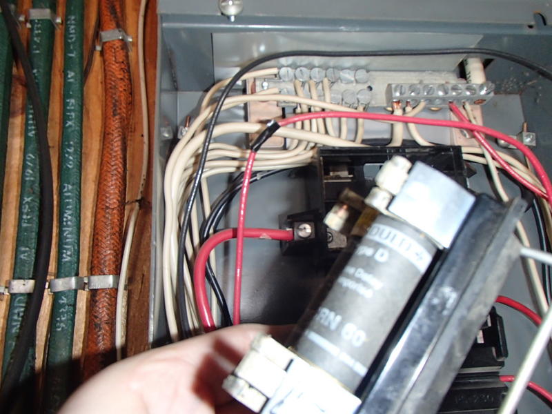

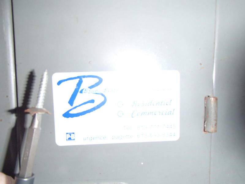

Client said electrician verified the panel and said everything is good!
That 60 amps. fuse is protecting stove circuit (8 gauge), 30 amps. protecting 14 gauge wire…
Electrician even placed is business info on the panel.

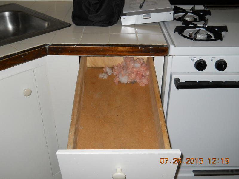

We noted: In the kitchen drawer what appears to be a critter nest. No critter was present at the time of this inspection. We recommend a pest control contractor evaluate further.

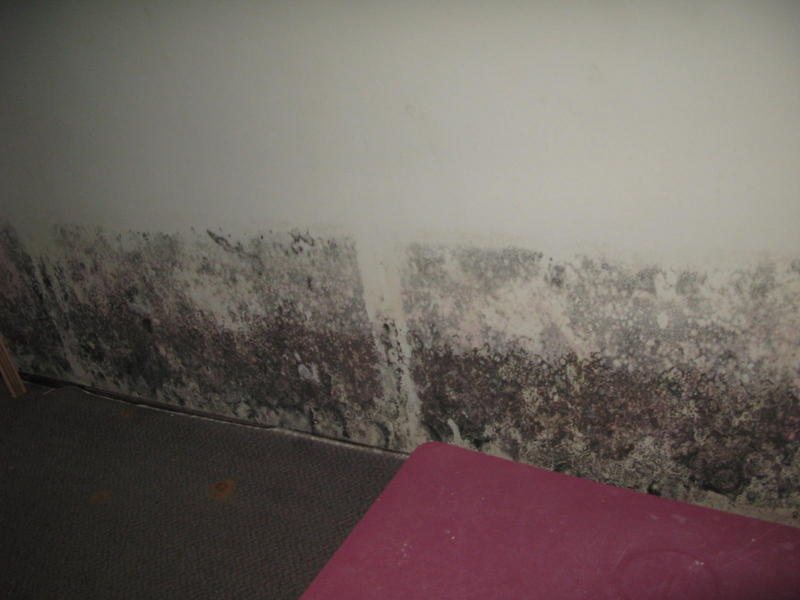

83 year old bachelor died suddenly in his front yard. His cousin inherited his house. Besides the mess, mouse droppings and this throughout the entire basement, the house was in pretty good shape. :shock:
That’s really funny! thanks for the laugh.

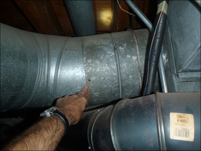

A wood stove vented into a forced air furnace heat supply duct.
“I was wondering why there were sparks flying from the registers”
Did they smoke meat in this home too.
Good one always new hazards Thanks… Roy

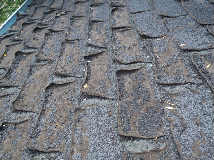

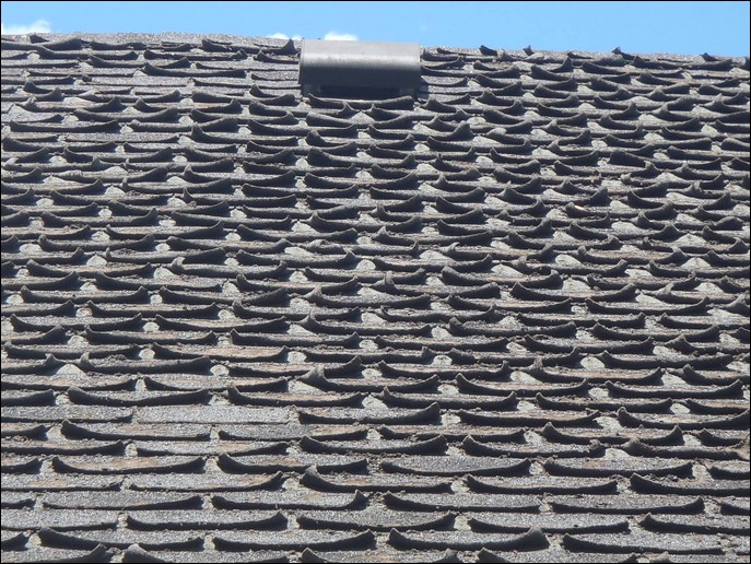

Is it how long it will last or how soon it will leak is the question. :mrgreen:
