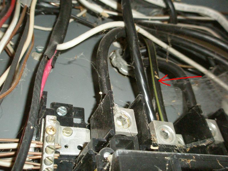

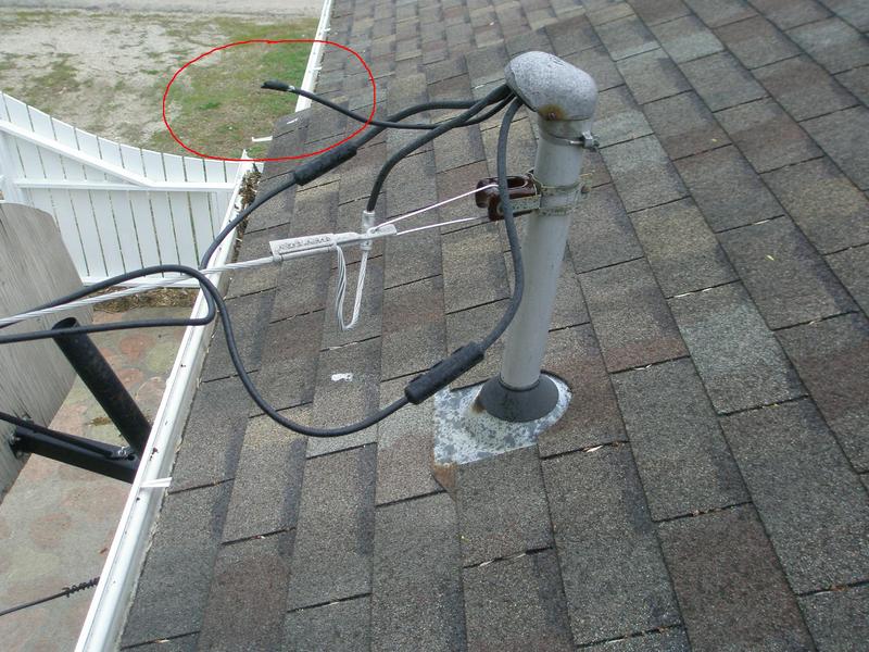

Nuetral wire at mast
What would the be the purpose of having an additional wire at the mast head? This wire is connected to the nuetral bus bar in the main panel.
The neutral is the wire that is connected to the bare wire that is connected to the insulator on the mast itself. I suppose that some included an equipment grounding conductor that is not needed on the service riser therefore it was not connected
