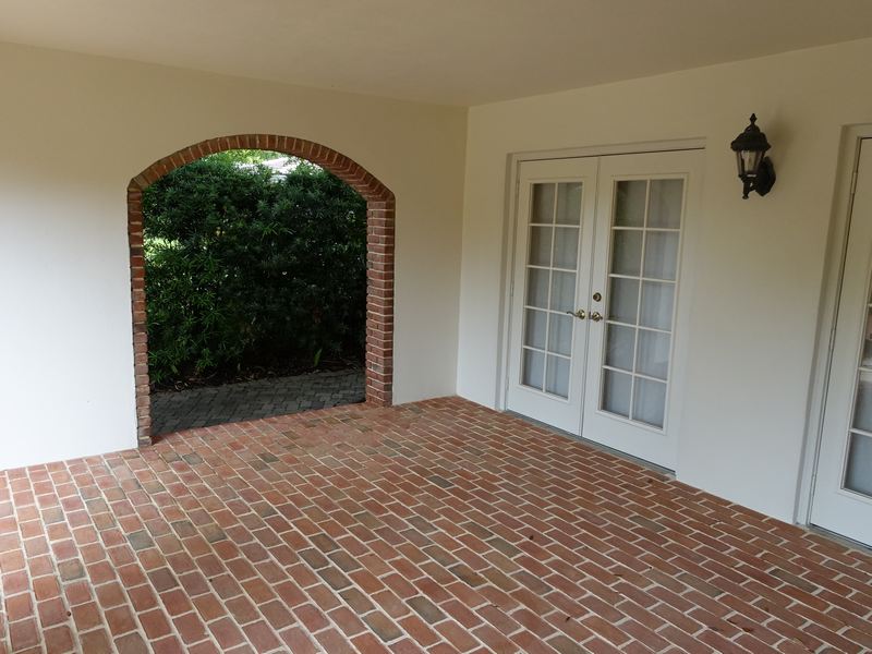

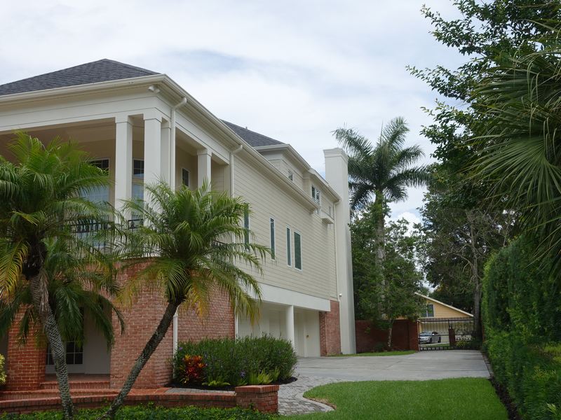

I am doing a wind mitigation on a house that has the second and third floors hurricane protected but the bottom floor which is below the flood level has no opening protection. the upper floor hurricane protection is extremely well installed and clean which makes me wonder if the ground floor is not required because it is below the flood level and not outfitted for residential living. it is basically all storage space and garage. does the ground floor need opening protection?

The walls are not breakaway. While I’m not familiar with breakaway walls, these are brick.
The upper floors have elaborate shutter / tarping all impact complaint. The lower floor has unprotected glazed doors. If I count the lower level as living space (it is not, it is on a flood plane) then they can’t get the glazing credit. The can’t get the non-glazed credit because the door leading up to the house doesn’t have a sticker but appears to be impact.
I’m leaning towards A on glazed and A3 on non-glazed. Thoughts?
Maybe you should post some photos of the ground floor walls. Breakaway walls can be deceiving. If the ground floor is parking and storage, most likely you will have breakaway walls - post and beam construction.
Break a way walls can be masonry block — just no rebar. They are usually in sections of 10’-12’ with cold joints. I used to design and permit these structures through the DEP (& DNR). Concrete slabs are saw cut 3’ on center so that they break up when undermined by waves. The whole theory behind this is so that the structure does not resist the storm surge and waves. They do not want the structure to block the wave action because if it did, the waves would be diverted laterally and harm adjacent structures.
I see flood vents in that wall, so breakaway walls may not have been required, but the windows and doors may have been designed to breakaway in a flood. I see your dilemma now. It most likely was built under what used to be “partially enclosed” design parameters. Best to ask your local AHJ about the required protection on the ground floor. If not required, then note that on the 1802.
