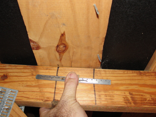

Help me out with this one. original roof was wood shake over battens. permitted and replaced in 2004 with aluminum shingles. (see the pic). they installed the new aluminum roof in the same manner as the wood shakes, 1x6 battens, double layer of felt and the aluminum shingles on top without using solid substrate.
So since the only section that mentions the batten system is line A.
any opinions on this?
oh and I know, nice plumbing stack and boot
I’d need to look up the code but I do know that some manufacturers of this type of shingle are OK with the battens.
I am more concerned with what to select on the windstorm as far as uplift pressures.
I would be inclined to put A until someone could show me that the uplift was great than A.
Because B and C both specifically call out OSB/plywood or dimensional lumber you will have a difficult time proving it will meet B or C.
I would check with the manufacture, I doubt they have the info you are looking for.
Thanks John, that is how I read it as well.

In your third pic, it looks like plywood showing thru a tear. Be sure that the did not sheet over the batons during the re roof. A 2004 permited re roof in Palm Beach should have required that for shingles…
If the roof was re decked, it’s likely not going to be an A. You will have to determine the nail pattern, etc…

If you look really close it looks like insulboard or foil covered ply wood.
yes I saw that as well, but probed multiple areas of the felt paper and did not find anything but the bottom of the shingles, and why would they lay new felt over the battens and under the plywood.
Don’t guess they would but I couldn’t tell for sure it was new felt like you could.
Often these roof are re decked w/plywood during recent re roofs. Especially when the wood shakes are being replaced.
They do not remove the old tar paper on top of the battens… You have to tear away a little to confirm the new deck…
In the third pic, I see a tear between the battens. There does appear to be a foil on the torn paper. But, it looks like plywood where no plywood should be on a batten roof…Unless, they re decked the roof during '04 re roof…
No new deck, It has to be an A.:slight_smile:

The home is in Palm Beach County wind zone 140mph, the re roof was permitted, meaninig that the minimum nailing was 6"x6" with 8d ring shank nails and would have been inspected as part of that process. The original nominal 1"x6" battons are spaced at 10" o.c. (4-1/2") between boards which would comply with that requirment. If you marked “A” you just screwed your cliet
