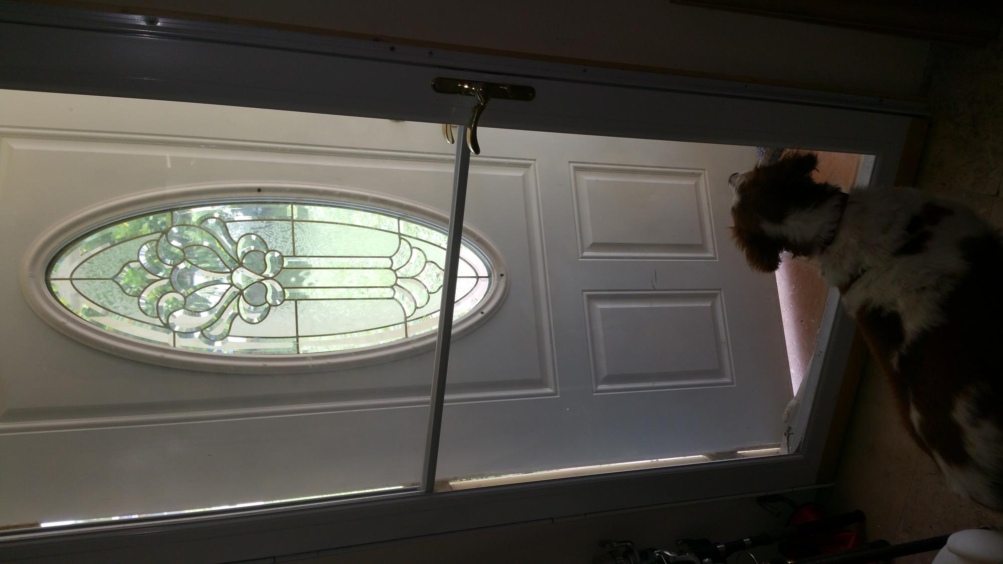

Out swinging entry door?
There are in-swing storm doors too.
Storm doors in Florida are retractable reel panels. Can’t say about the northern storm doors but if the entry swings in, I would think the storm door swings out similar to a screen door arrangement.

This is an out swing entry with in swing storm door. Roll ups are storm shutters.:wink:
