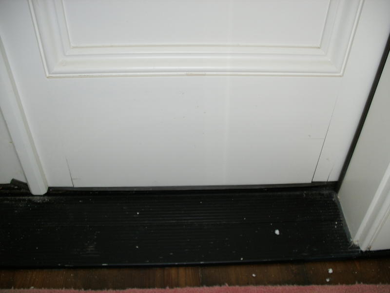

I have a client who has about 28-30 outward swinging french doors. The contractor who installed them, installed the Endura sills backwards (threshold facing inside) and every door has leaked causing damage to hardwood floor. He told her that they were done that way because the doors swing outward.
In addition, they installed the windows on the 3rd floor backwards, causing gaps which have leaked. They installed double hung windows on the 1st and 2nd floor. The contractor ordered the wrong sized windows and had the nail the top section of the window shut and installed a small piece of molding to act as a backstop for the bottom sash.
Any thoughts or comments? Do anyone have a diagram of the installation of outward swinging french doors and the thresholds?
