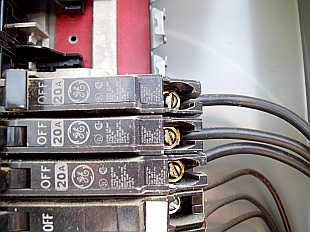

Oversized wire
I found this in the Main Service Panel today. #8 stranded copper installed in 20 amp breakers. I know undersized wire is wrong , but I can’t find anything that talks about oversized conductors. I would appreciate any input / education on this subject from you Sparkys out there. Thanks , Rick
Should I not be concerned with this ?
Richard, so long as the wire size is UL listed for the breaker there is no problem, code is " a minimum std" only. I would much prefer a conductor be oversized, than a breaker be undersized. The weakestlink is still the breaker, not the conductor.
Regards
Gerry
Thats kinda what I was leaning towards . Thanks Jerry !
You sure about that Gerry? :slight_smile:
