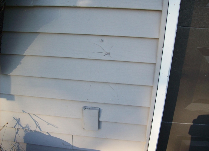

Seen my first house yesterday with painted vinyl siding. From a quick internet search there are companies that make paint for that purpose, but the devil is in the details , like surface preparation. Anyone inspected a house with paint failures? I would like to see some photos if you would share.

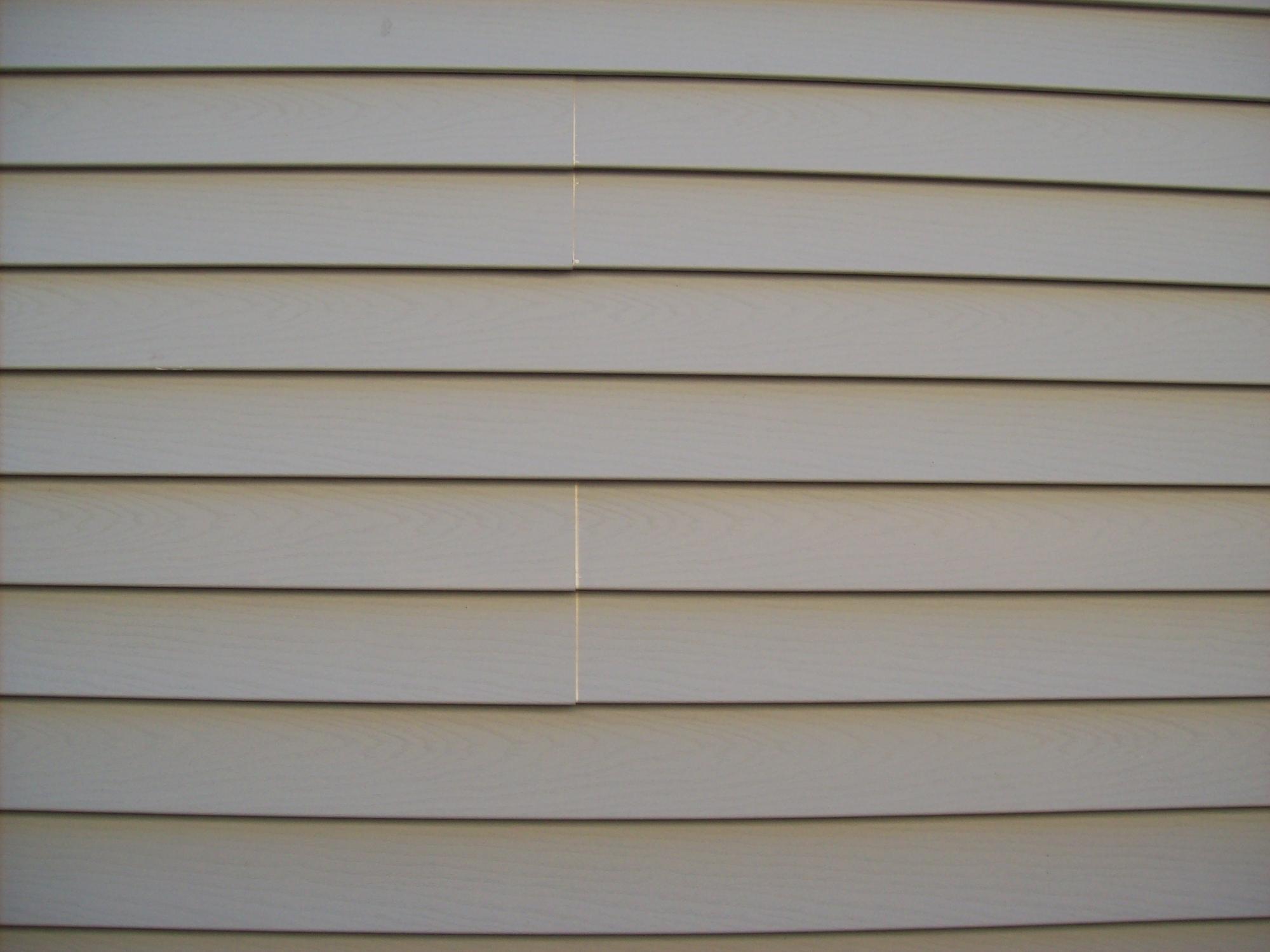

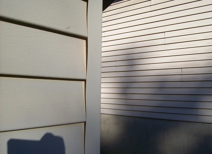

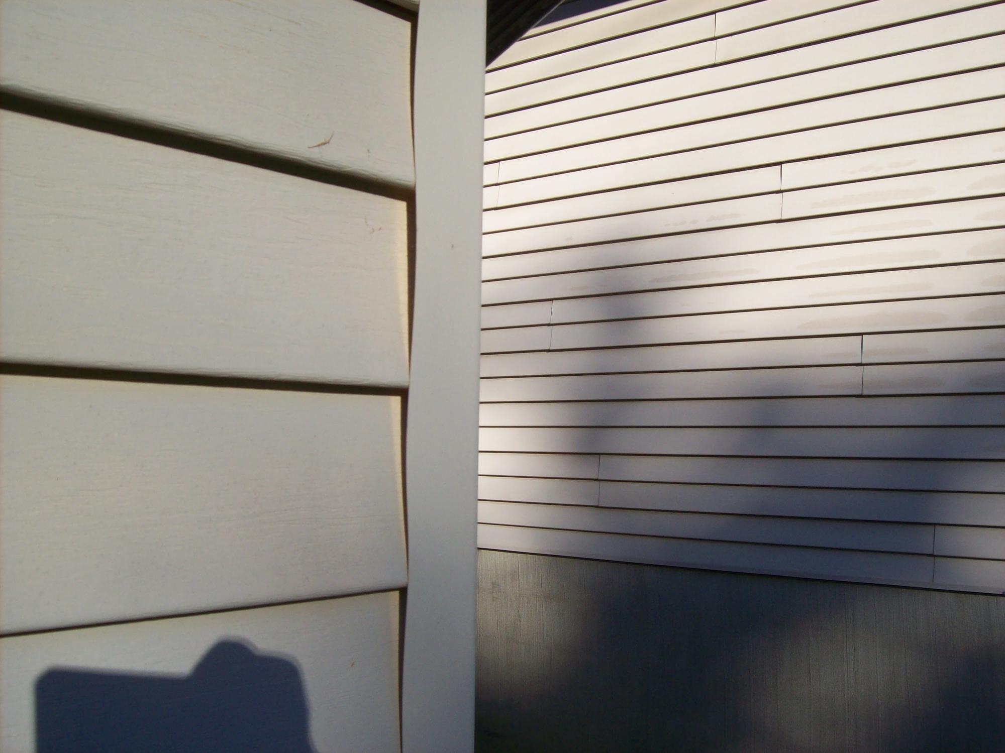

Like your picture it shows the joints when the cold causes the siding to shrink, The did brick and Garage door too .

I have seen it before Randy but the only problem was the over laps when the siding moves during expansion and contraction.
