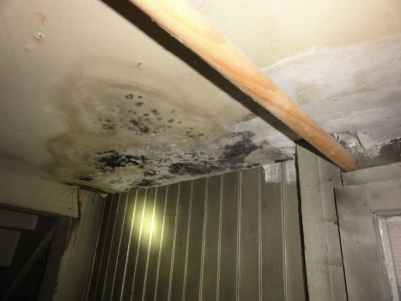

You should see the garage structure as the top plate is bulging from the addition of an overhang attached to the rafter tails and causing stud lean at both sides.
I actually document a Carpenter is needed to make repairs and investigate the cause if possible IMO.

No idea what happened to the other feed.
Has two meters at back with both spinning
I was a little distracted under the porch for obvious reasons…:slight_smile:
Yes …checkout the window trim for a clue as to the cause.

Is this an investor special?
rental 2 flat plus typical 3rd in basement .
So you guys wonder why my reports are long?
I get lots of older 2 flats and they all need extensive work which I document though I often wish I could make a one page report with the words.
“Get CONTRACTORS.”
