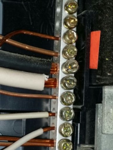

  1. Inside this panel I see some knockouts missing at top but there is black goop on feeder inlet. Is this ok?
  2. I assume the conduit stubups are ok, for the branch wiring Advise if otherwise.
  3. There is a black wire on the neutral bar but no white tape or anything. Should I highlight this as a concern for an electrician to review?
Thanks
Steve

The black “goop” is likely duct seal and is required {300.7(A)}(although almost no one uses it or a similar product). The two PVC nipples can be code complaint if they comply with all of 312.5©Ex. A black conductor can be reidentified as a grounded conductor if it’s #4 AWG or larger {200.6(B)}.
And I do not see it as being compliant with 312.5© in it’s present form…lol…just saying!
Close, but wrong for a variety of reasons.

Jim, can you elaborate on “variety of reasons” Thanks
Steve
No bushing on the pvc sleeve. The sleeve looks shorter than 18" required to use this method. Possible overfill issues. See the requirements listed in Paul As post.
Perfect thanks!
That wire attached to the neutral bar is not likely to be a neutral, more than likely it’s a grounding electrode conductor. Unlike a neutral (grounded conductor), a equipment grounding conductor, or an equipment bond, it does not need identification.
In fact in the Chicago Code 18-27-250.64
Could be a GEC. I would think that since there are separate EGC and neutral buses and an EGC in the feeder possibly making this is a sub-panel which wouldn’t have a GEC.
Could be a GEC but I would then wonder what the green conductor run with the feeding conductors is.

Raceways for grounding electrode conductors shall not contain other conductors. The outer finish of an insulated grounding electrode conductor need not be identified except that it shall not be white or green. Flexible conduit and armored cable shall be permitted to be used in existing buildings for grounding purposes only where this ground is concealed or a major portion of the ground is concealed. An approved nonferrous metal tag shall be attached to the ground clamp giving warning against its removal.
Strange that Chicago does not allow a green EGC.
It does require green or for an EGC, but says no to a GEC. It makes sense because chicago says to pipe with no other conductors for GEC, so it is not possible to accidentally splice into it. It’s a lonely wire, who cares whether or not it is identified? An EGC, however, can be run in pipe with many other conductors along with it, so it must be identified to differentiate itself.
I would bet they are both GECs, the black to water, and the green to the rod. Either two different contractors, possible panel replacement, or green is just what he had on the truck. Either way, neither would be a violation if I’m right about the black being a GEC.

If that’s the case then you’re saying that someone ran a GEC (the green conductor) through the meter enclosure all the way back to the panel?

Of course. It just can’t bond with the neutral in there, which is usually what happens and why it is (sometimes) a problem.
