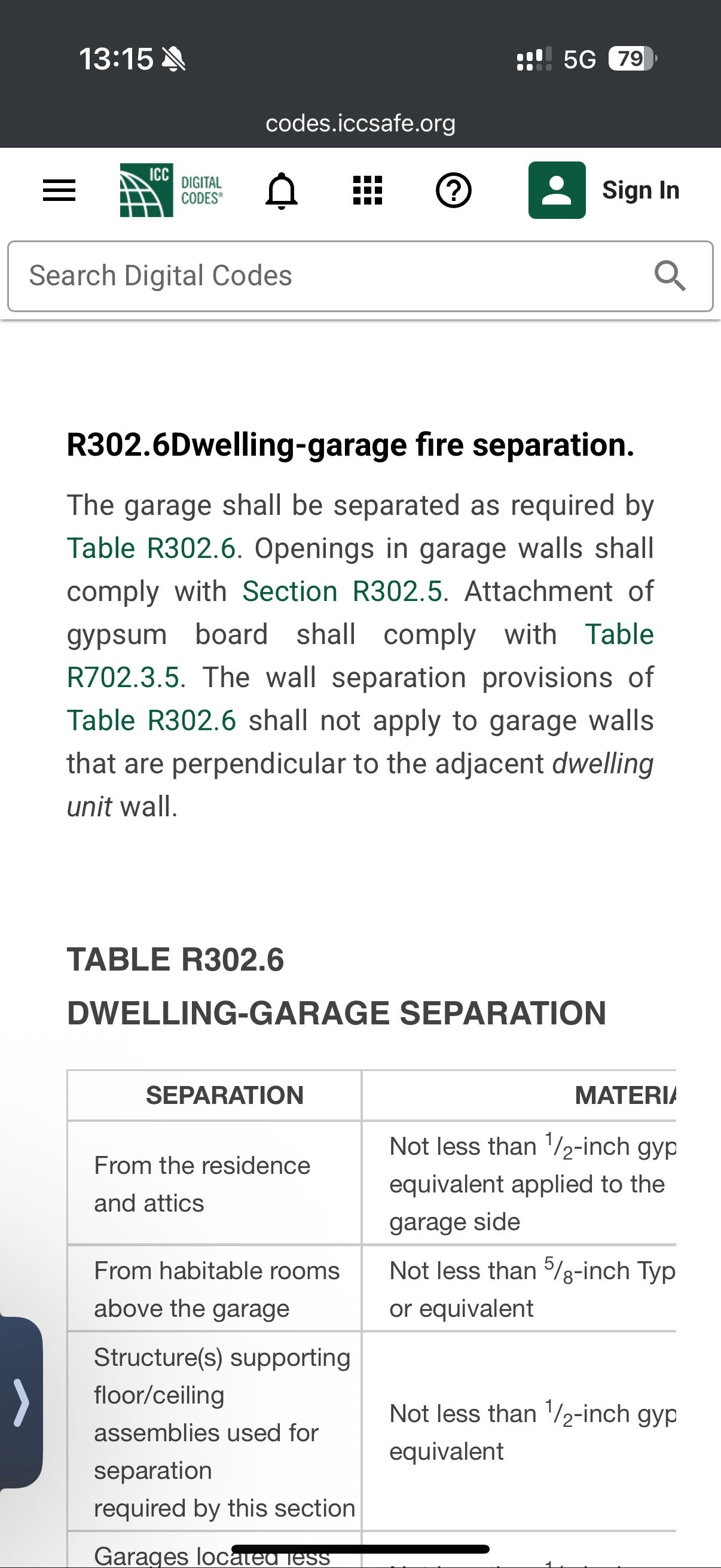

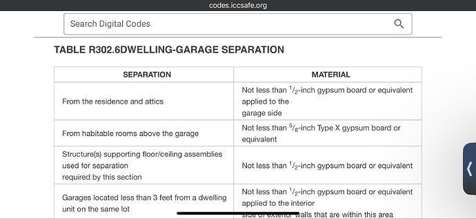

A question came up today about having a passive vent in a garage ceiling. The question was regarding fire rating. Is a passive vent allowed in the garage ceiling or does it pose a safety hazard when it comes to fire rating? I’ve seen them a lot here in Florida as attempt to move some of the hot air out of the garage. Is there a Florida building code or international residential building code or diagram that shows why it is a hazard?

It’s not for combustion air. It’s just a vent for the hot air in the garage to go into the attic. I’m just curious if this affects fire rating. Or do you know a section of the Florida building code that covers fire rating in garages?
It just goes from the garage directly into the attic. Just imagine it’s basically a hole between the ceiling drywall and the attic space but there just happens to be a vent inside of that hole.

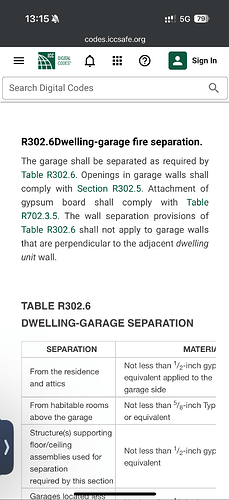

It’s in Chapter 3.
Found my answer! Thanks code master fetty :joy:.

Fail it! There should be no opening, your vent, or HVAC ductwork. This gives a path for fire to spred to the rest of the house.
If there is not drywall in the attic separating the house attic from the garage attic, then it is wrong and should be covered up. If the garage attic is separated by drywall from the house attic, then it is fine.
