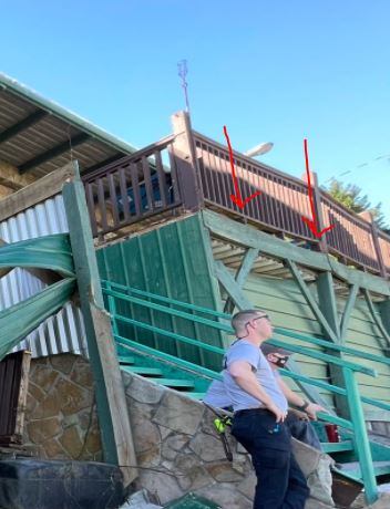

While ledger board failure continues to be the most prevalent failure, it appears that this deck failed at the outside posts.
Owner negligence. Very sad indeed. I wonder how many commercial businesses have older decks in need of maintenance? I hope this raises awareness for other business owners and insurance companies.
Even more discouraging, the deck was in an obvious state of disrepair and failure that was easily identifiable by a laymen.

Another deck failure in Malibu, with multiple injuries. I have a deck finding category “Multiple issues observed”, listed as a safety item. It’s amazing how often I use that category, along with half a dozen or more photos of the issues present. Deck issues are definitely an inspection component to pay attention to (along with the rest of the inspection components). Decks are a popular DIY project, completed by individuals not familiar with good construction practices.
