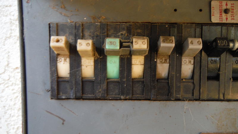

People do the stupidest things....
Wouldn’t you know, the only breakers with a handle tie… Oh well
Haven’t had my coffee yet. I don’t get it. Whats the rest of the story?
Looks like the 2 - 50 amp breakers to the left of the 30/50 and the 2 - 40 amp breakers to the right should have handle ties…
However just judging from the outside of this panel I’m worried this could be the least of the potential problems with this panel…
I would be curious what all these breakers are feeding…
The 30/50 was feeding the dryer circuit with #10
That would have been nice to know in the OP.** Now** it makes sense.
Sorry… posted it after a days work and I was tired. Made you look though! :smiley:
That’s one of those OLD Zinsco panels. Mid to late '50’s would be my guess.
Yep… house built in 1958
