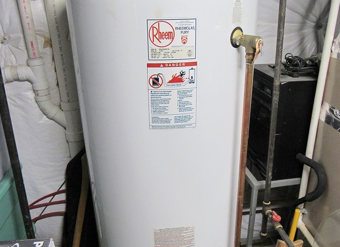

As part of the Energy Audit class, this is a photo of my water heater. It is 18 years old, original to my house. It is a 75 gallon, natural gas water heater, and the water supply is public. I have a whole-house water filter in my house, which has been in use for 18 years. It is amazing how much debris it captures, and may be the reason my water heater is functioning so well. The gas supply to the tank is black iron, there is a sediment trap properly placed, and the flame and draft are good.

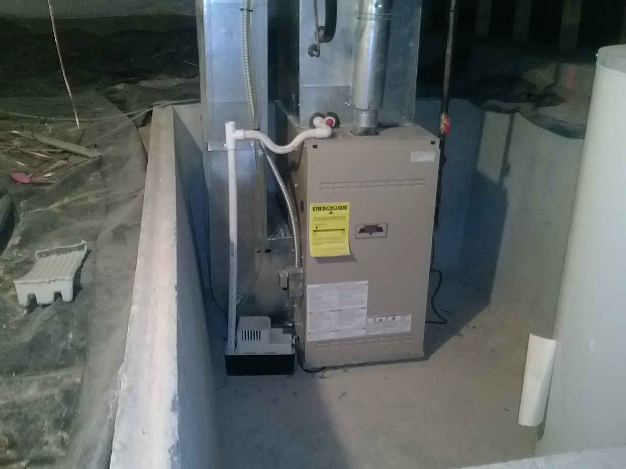

https://goo.gl/photos/8Qp69ftmr1wD7bXf7
Link to image above if attachment doesn’t work.
This image shows an enclosure in the crawlspace that houses the water heater & furnace. Using this would be problematic for doing the CAZ tests. I think getting the pressure to change would not happen due to the vented crawlspace area. I will be checking with a BPI professional in my area to see how they deal with these. I have never seen this kind of enclosure and personally feel they would be more hazardous if there were a (heavier than air) gas leak as this 4X8 space would completely fill if there were no pilot or other source of ignition to cause an explosion much earlier.

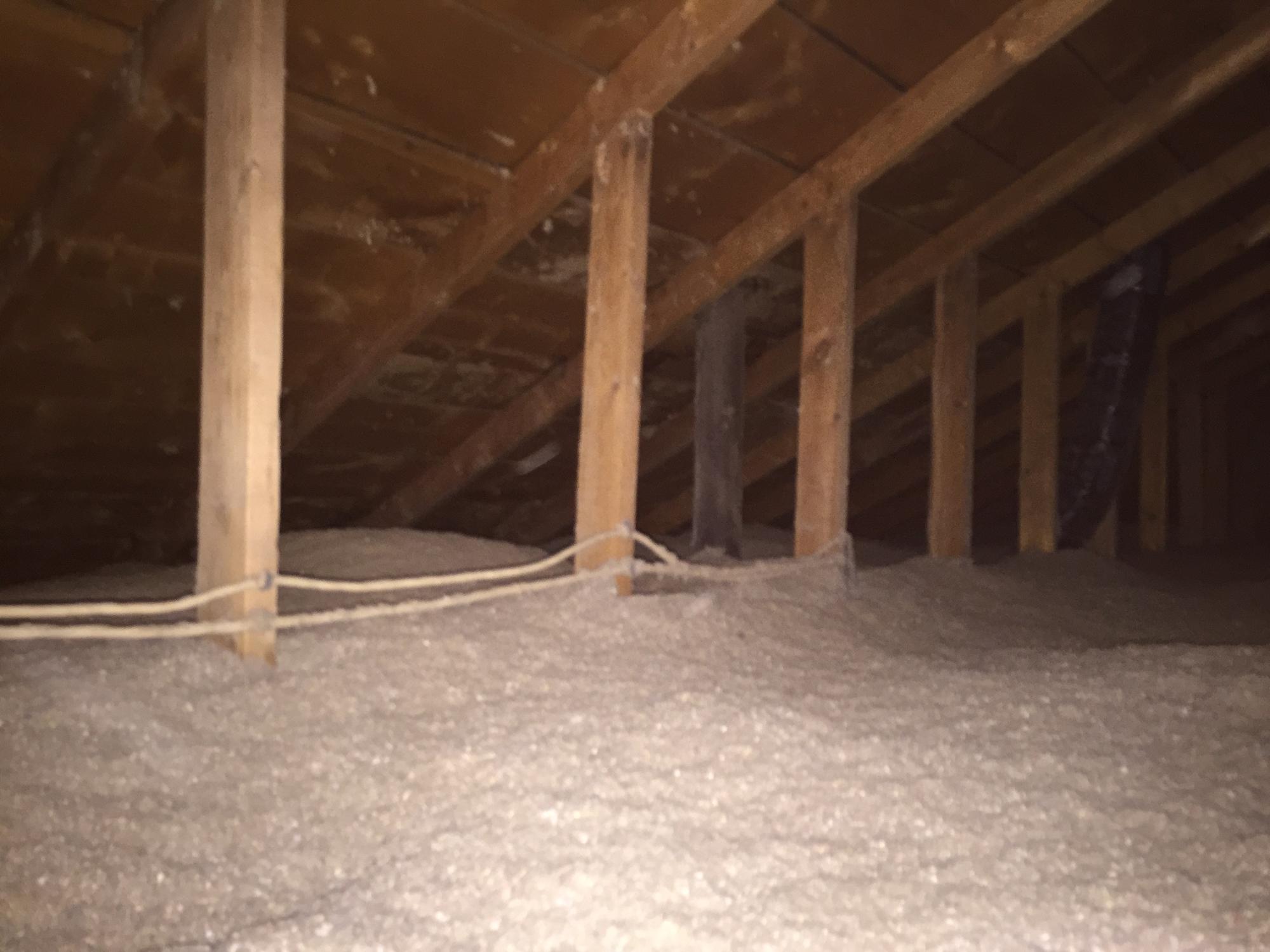

The home was built in 1930 and had insulation added sometime over it’s life. The insulation has settled to below the top of the joists and has compacted. There are no baffles installed at soffit vents and some vents were blocked by the blown in insulation. Attic hatch door was not insulated and caulk needs to be applied to penetrations under the insulation.
This picture illustrates too little insulation in the attic. The ceiling rafters are 2x4, making this approximately 1-2 inches of insulation. In addition, knob-and-tube wiring ran through the attic. The installation of additional insulation was not recommended until the wiring had been evaluated by a qualified electrician.
