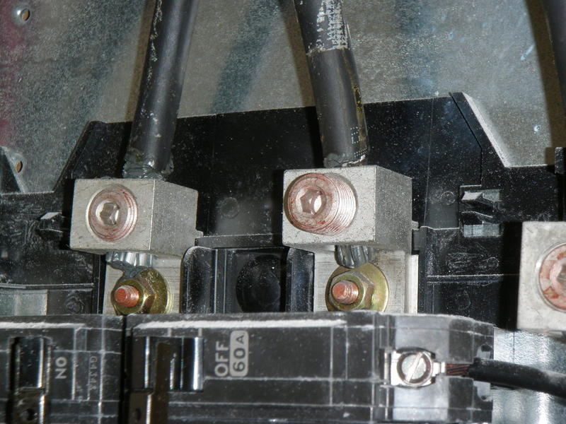

Phase B Lug...OOOPS
Another loose wire noted. Phase B (right side) lug is loose and a huge safety issue. For the people who do not remove covers, man are you missing significant defects. This is the second time in a week a major defect was noted within the panel and could not have been found if the cover wasn’t pulled.

Russell - good catch - that would be easy to overlook even with the cover off.
did you happen to check the panel with an non contact thermometer? I am in the habit of doing so. that would likely have shown up as well
I carry one but still use the back of my fingers to check breakers for heat 60 years ago when I started the trade that was the only tester we had also for hot motors Hand on the motor if you can count to ten it was not too hot . We sure learned to count real fast some times .
I did not tighten it. I do not have the proper equipment, training or qualifications…

An electrical engineer did this to my own panel and almost burnt my house down. I had to change the panel and breakers.

I would have tightened it.
With what?
Please never try it.

With a torque wrench :roll:
Explain exactly how you would go about it with dieing.
Like I said don’t even consider it if you don’t know what you are doing.
The only way I would do it is if the meter head was pulled,not that I know anything about that stuff.
