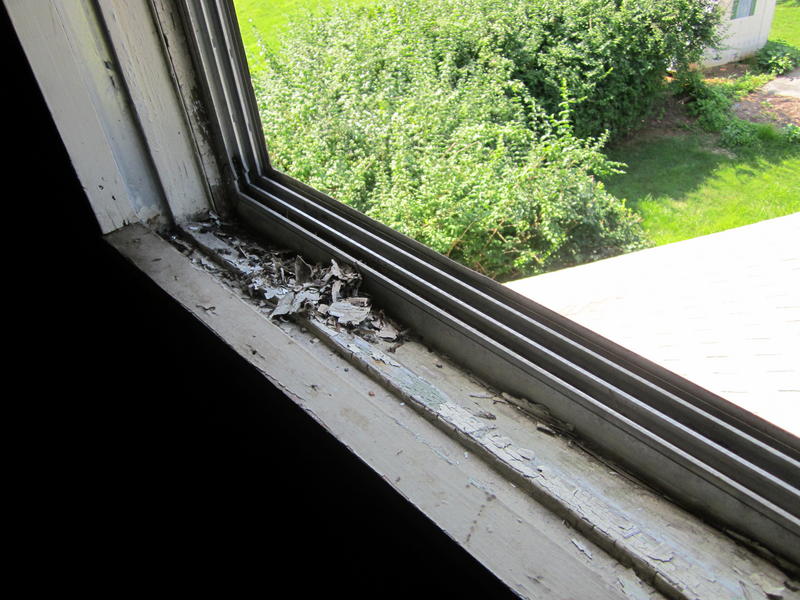

Picture or illustration request for exterior storm window weeps.
Does anyone have a picture or illustration of a window storm weeps to use in a report to educate a client.
Today’s blocked with debris, water infiltrating into interior.
Thanks!!
only pictures of how not to do…
When installing storm windows, we would only caulk the headers and side flanges…
Capping of sill would run under the lower sash at sill…
free drainage at the sill to exterior if screen was open…
and we were the exception?
Have not been checking for them much latley.
Thanks for the reminder .
This one is from a few years back.
Reminder…tag photos you may wish to use again for illustration.
