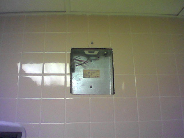

Can I add these to the list??
Hospital Emergency room!!
Waiting for Doctor!!:frowning:
The second picture looks as if it is a box for a clock or similiar device. The wires that are loose are from a battery. There is also a housing ground condutor wire and in the upper right corner you can see an empty conduit (fitting) that has no wire so I am guessing this looks worse then it really is… Sorry not as dangerous as I thought.
