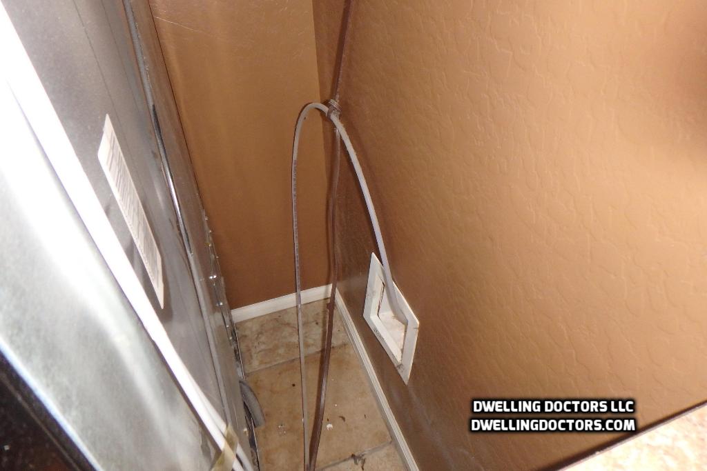

It made me laugh.
 ![addtext_com_MTUzNjE4Mzk5NDIy.jpg](https://global.discourse-cdn.com/internachi/original/3X/0/6/06fa8b4e15333110f5210179367ea27c695bead8.jpeg)

Not a bad idea keeps the rollers on the frig from rolling over the line. Had that happen to my own line when the contractors were re-modeling my kitchen and my water supply was stainless steel flex and it mashed flat

Nothing should be attached to the electric cord…stupid idea.
It will yank at the electric plug.
Line has to be copper here 1/4 inch.
They can use a regular wall bracket or shorten the line.

Manufacturer warns not to use plastic.
[http://manuals.frigidaire.com/prodinfo\_pdf/Anderson/241811505.pdf](http://manuals.frigidaire.com/prodinfo_pdf/Anderson/241811505.pdf)
yeah yeah my tires are 20 years old and never went flat argument coming.]
CAUTION
To avoid property damage:
• Use copper tubing for the water supply line (plastic
tubing is more likely to leak).
• Ensure water supply complies with local
plumbing codes.
