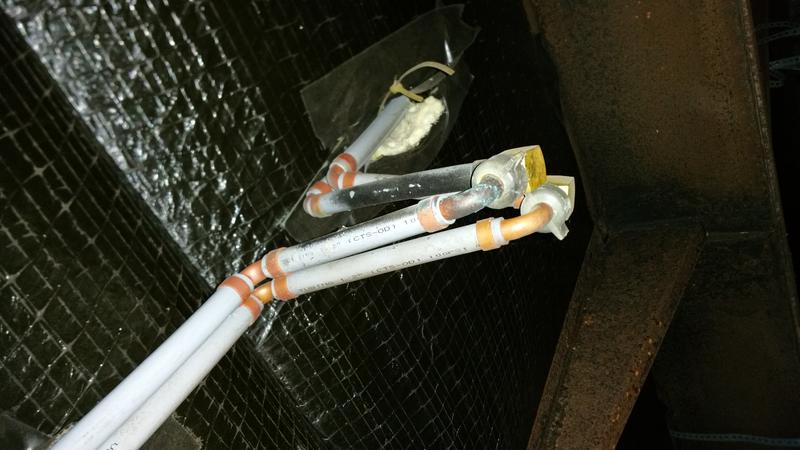

i was just wondering if this is polybutyene piping. manufactured home built 1992

It sure looks like it, did you see PB2110 on the pipe?

no i couldn’t find that on what i could see

Look like pex in the pics.With some PB.
