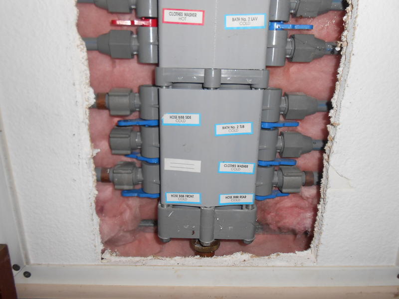

![DSCN3685.jpg](https://global.discourse-cdn.com/internachi/original/2X/c/c8c53d87a541d277807ee8851e32d0a0137825cf.jpeg)
 ![DSCN3691.jpg](https://global.discourse-cdn.com/internachi/original/2X/9/9c3636a2806789b2269d9b76e03f7724c718cd59.jpeg)
 ![DSCN3689.jpg](https://global.discourse-cdn.com/internachi/original/2X/1/10a11dcb0aa722292b1b2240f5062fde6d9bbe48.jpeg)
This 1994 Florida home has recently had the plumbing lines updated with a PEX Manifold system - great! However they left 3 lines as Poly B which is for the outside hose bibs. Is this ok to leave Poly B on the outside lines?

**Author:** ![ddagostino](https://sea2.discourse-cdn.com/internachi/user_avatar/forum.nachi.org/ddagostino/32/60136_2.png) [@ddagostino](https://forum.nachi.org/u/ddagostino)\
**Post date:** [November 21, 2012, 2:15pm UTC](https://forum.nachi.org/t/poly-b-on-the-outside-hose-bibs/73580/7 "2012-11-21T14:15:50Z")
</div>
Michael,
Are those photos from before the re-pipe? They show a poly manifold, not PEX.
Anyway, any plumber that didn’t run new lines to the hose bibs is short-changing the client. They still have active polybutylene in the home, and insurance will be an issue as well as leaks. I also doubt that arrangement was permitted and inspected by the City or County.

I greatly appreciate the responses, and the points mentioned. I admit this is my first time on IterNachi Forum’s and relatively new to the industry. I have called the outside hose bibs lines in the report as Poly B, but I believe the rest is an acceptable flex type tubing manifold system. When you guys say Poly do you mean - polyurethane pipe or polybutylene? My understanding is Polybutelene is the only red flag item. Here is a better picture of what I think is the non polybutelene pipe in the manifold and acceptable…I am right?
 ![DSCN3686.jpg](https://global.discourse-cdn.com/internachi/original/3X/a/1/a1d0ba7d337f6b124d8e4b0f5ca5d0a263a491f9.jpeg)

> [@mtobbell](#):
No. All the piping in that photo is polybutylene and should be called out. That manifold isn’t compatible with PEX, and the house needs a re-pipe.
Dom.

It’s all PB. It just happens that only a couple of them have copper crimp-rings.
