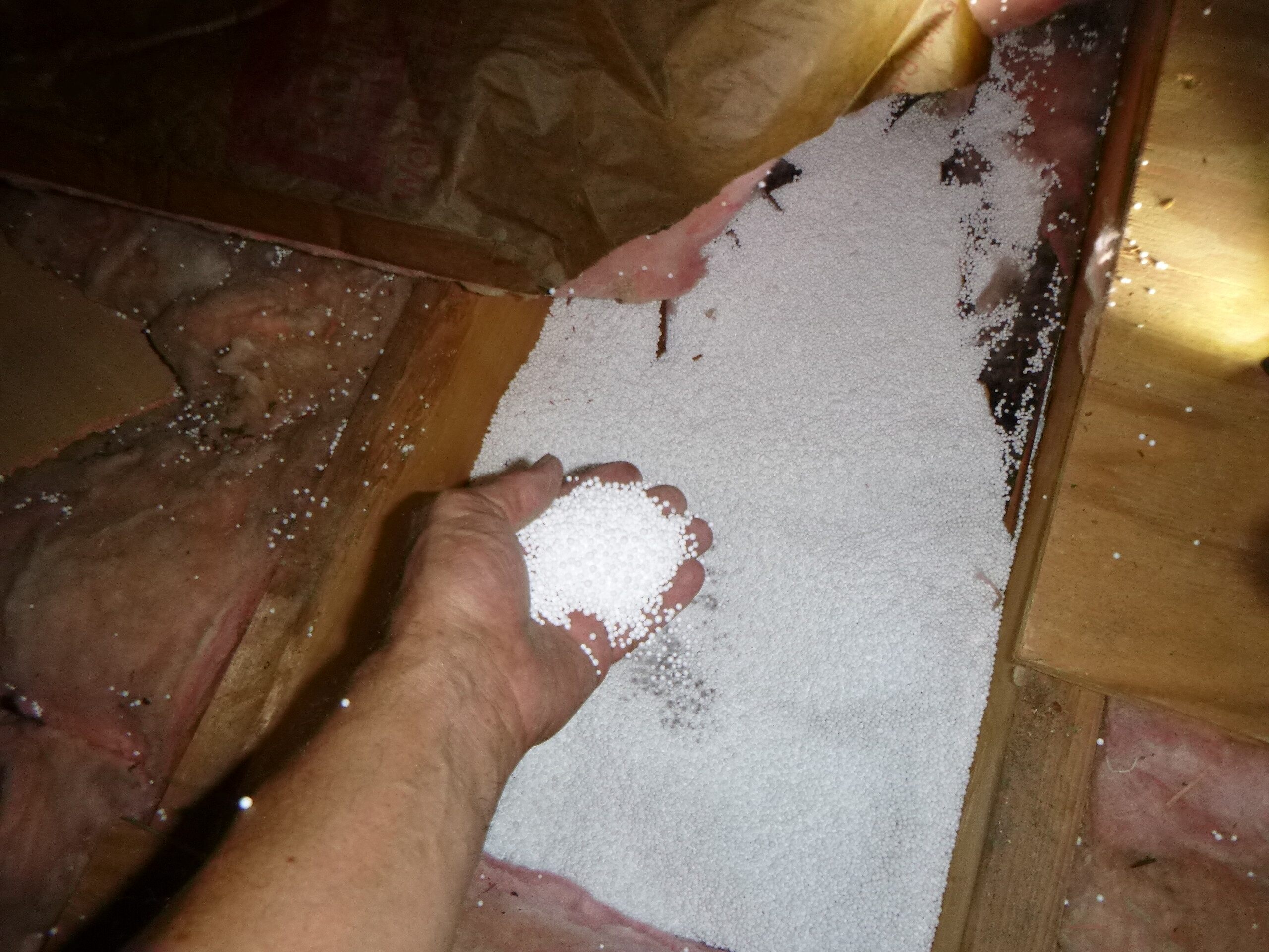

Has anyone come across EPS (polystyrene beads) being used as insulation in the attic? Is this even permitted?
This is in a New Jersey shore house built in 1978. The beads are under fiberglass batts.

Polystyrene contains the toxic substances Styrene and Benzene, suspected carcinogens and neurotoxins that are hazardous to humans.
I’ve seen it 12" to 14" deep in some attics. :flushed:
Ecobead, EPS, Ethenylbenzene homopolymer.
Untreated EPS foam burns at 650° to 700°F with a flame source. It won’t continue burning on its own until 840° to 930°F is reached. Wood burns at 480° to 660°F
That answers my primary concern of being a fire hazard.

Be on the lookout for perlite in attics and basements. That was I though the white objects were at first but notice the prefect orbital shape and sided with EPS.
Perlite insulation John Mansville was a large producer…
Health and Perlit. Perlite has been characterized as a nuisance or or inert dust. Exposure to such dusts can sometimes result in temporary physical irritation, discomfort, impaired visibility, and enhancement of accidental potential, but not to health impairment.
Are you sure it is not perlite? It can look and feel similar to Polystyrene…
Good question. I have never handled perlite. But this has all the characteristics of EPS. Including the static cling. From the pictures that i have found of perlite it looks more like EPS.
