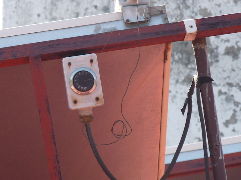

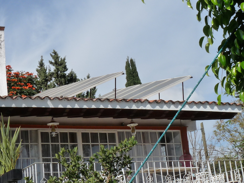

The air temp here is a pretty constant 72F. The pool here is about 70 F and I’d like to turn it up about 5 degrees. The pool guy says he can’t. I don’t believe it. There’s got to be a mixing valve somewhere. There’s no control in the underground mechanical room that I can recognize as maybe controlling water temp.

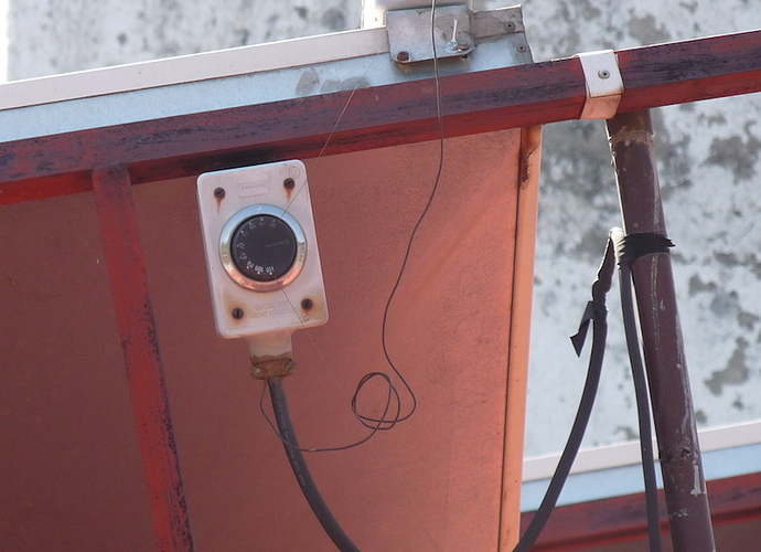

This is the only control I can see without climbing onto the roof, and I don’t have access permission. Does this look like a thermostatic control for water temp?

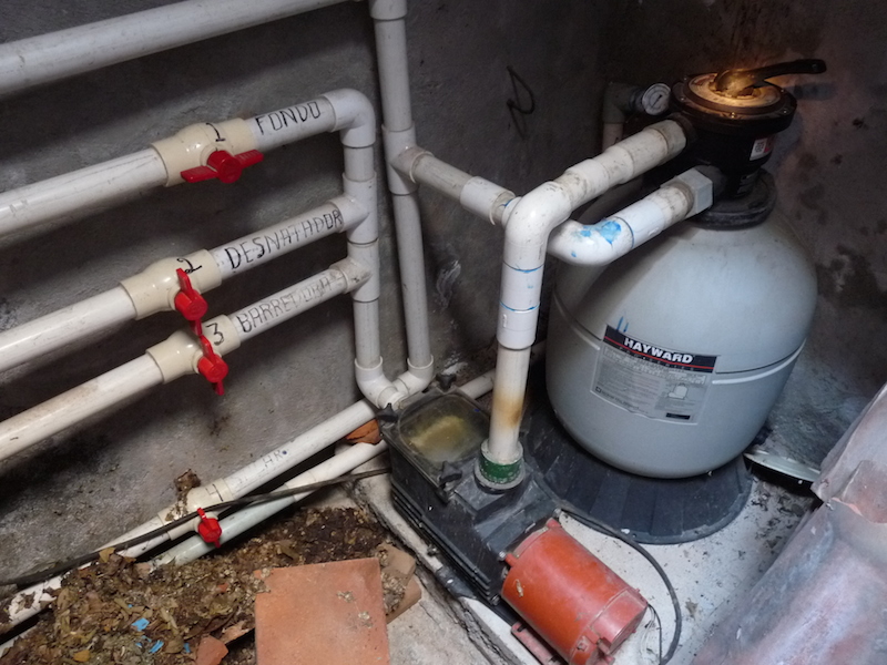

The mechanical room. Pump not grounded that I can see. This thing going to kill me?
On a gas heater, it’s pretty simple. On a solar heater as pictured, you, of course, are limited by what the sun does. But that said, solar heaters can be pretty effective when they’re not leaking (and prone to leaks appears their biggest draw back). Most pool heaters I see are gas, and the few solar heaters I’ve seen didn’t have an actual temperature control thermostat.
Pool pumps don’t have to be grounded per se at the pump itself, they have to be bonded.
The electrical system as a whole should be grounded, and that fuse box looks pretty scary.
It looks like a shock hazard from here.
There’s no grounding or bonding of any electrical components on this property, or on most properties in Mexico.

I agree. I’m not going back into the pool until I ground the pump and replace the breaker with a GFCI type. If the fuses were bypassed because they kept blowing, that indicates to me that there’s possibly some other electrical problem, although I’m guessing that the fuses were the original. OCPD and once the breaker was installed, they decided to bypass them with the wire.
…and, as far as the temperature control, there should be something that’s basically a TPR valve for water running through the tubes in the panel, and that valve would be set to open at a pre-determined temperature. And then there’s be a mixing valve that controls the temperature of water entering the pool. This is pretty obviously a thermostat calibrated from 30 F to 110 F, so I don’t see what else it could possibly control.
