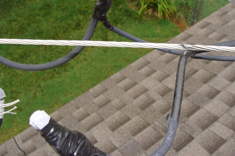

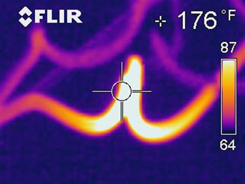

I have observed some poor electrical work in my life but this one takes the cake I am still shaking my head
 ![3005 Canterbury PC 8-11-08 019.jpg](https://global.discourse-cdn.com/internachi/original/3X/7/e/7e0ae41912e070a3419517a3ef36d4d60e9ba84f.jpeg)
 ![3005 Canterbury PC 8-11-08 020.jpg](https://global.discourse-cdn.com/internachi/original/3X/8/8/8888a3859d642eb2d46427c51311e7cc3186e7ce.jpeg)
 ![IR_0641.jpg](https://global.discourse-cdn.com/internachi/original/3X/a/f/afd09bc9dd486adcf0c1c73b6a081dcb7df9f1f6.jpeg)
 ![3005 Canterbury PC 8-11-08 041.jpg](https://global.discourse-cdn.com/internachi/original/3X/4/2/4261694041631063eb94428ee69a74bc8f8f9d3f.jpeg)

That looks like a temporary hookup that the PoCo never reconnected properly

Gotta love how those nuetral wires are connected!:shock: A whole two strands! Yikes. It looks like you could sneeze near that and the wirenut would fall off and the wires would spring apart.

Sorry guys No Poco on this job I know the guys that do this and they would never have assumed the libality for that. That was a home owner job. There was another splice in the incoming service where the wires had rubbed on the shingles of the hip roof and someone had added pipe to the weather head to raise it above the roof and then re-connected with wire nuts small ones at that. Had home owner wrote all over it or perhaps his brother-in-law

You don’t seem to understand. Nobody said the PoCo did that. It does look like something an electrician or a homeowner did, in anticipation of the PoCo coming back in a few days to connect it properly. This is quite a common thing to do, but sometimes the PoCo drops the ball or the right phonecalls never got made, and these temped in connections end up staying that way.
