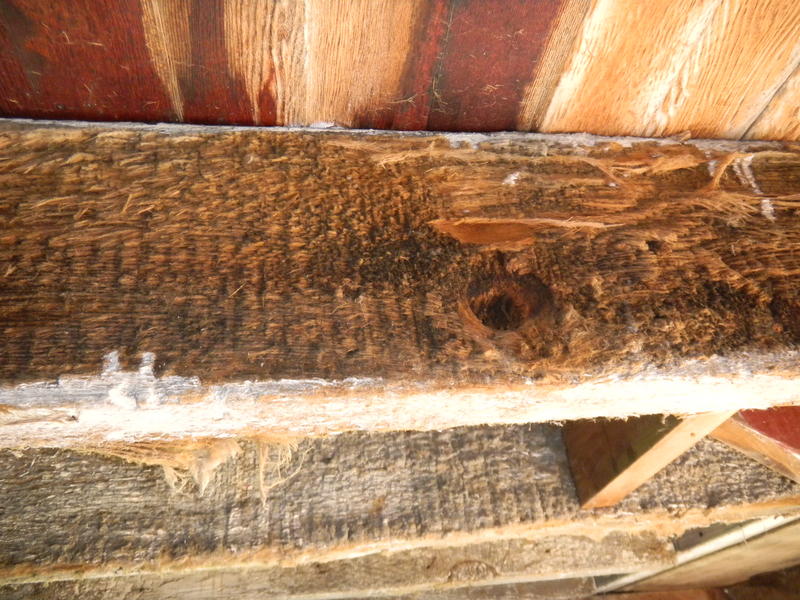

These joists for a porch have deterioration and what is similar to horse hair effect. Is this caused by moisture?
It looks like rough sawn wood to me.
Water damage / rot
Did you probe.?
Looks like rough sawn lumber to me also with a bit of fungi on same which often is not wood destroying.
How close to ground contact are you looking at?
