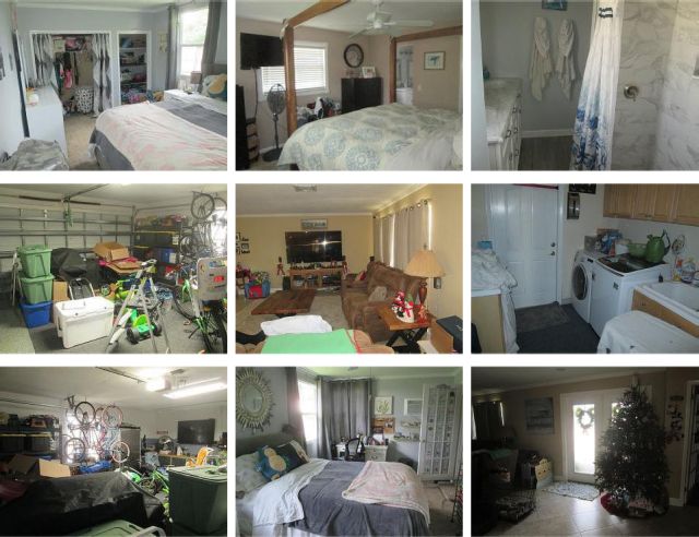

If the home is occupied I also stick this in the report and I actually put it in the Summary as an advisement so they actually read it…
ADVISEMENT: Because this home is/was occupied on the date of the inspection and or may have stored items on the premises, many areas were not, or may not have been accessible for a full inspection. Also furniture, area rugs, pictures or other personal items may not allow for complete observation of some areas. It is very important to visually check all areas at final walk-through that may be hidden from the inspector when the inspection was actually performed. This is especially important for walls, floors and closets. Any damage or deficiencies that are observed at final walk-through that are not shown or covered on this inspection report should be noted and resolved before taking possession of the home.
I also have an “advisement” (like above) for the Garage if it has anything stored or parked in it… and I will normally put a picture showing that there are areas that are blocked. Also good to take a bunch of pictures especially in occupied houses to show condition on day of inspection, just in case. (I take 360 degree pictures of every room, the garage and all sides of the home. (invaluable resource)
I put this @ the end of the report.
Notice the closet doors (showing storage) are open for the pic. :cowboy_hat_face:
pics1 #917121
pics2 #917121
