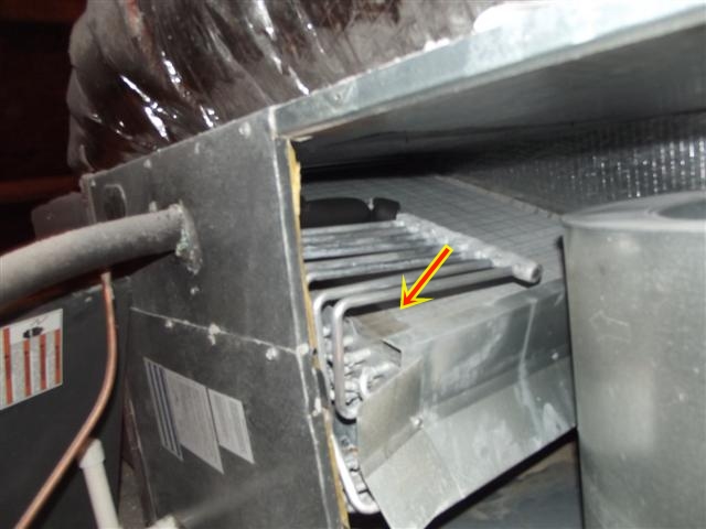

Problem or not

Secondary containment. too large, blower not in optimal position, upside down coil, short cycle, all my avenues have been exhausted.
Ok guys I am done gaming tonight I gave it away with the words big sucker. Take a look at the 3rd pic there is a botched up piece of metal trying to block the coil from the blower section to prevent condensate from being drawn into the blower. Look at the suction side of the blower it hovers over the condensate pan and is going to suck condensate from that pan and probally drop some water into the furnace housing that is going to drip on the ceiling outside of the safety pan. Its going to make a fricking mess in the cooling mode.

Having the coil on the other side would have solved that big sucker ;-)…
You do not think a properly sized return duct would solve that issue ?
Since the pan is tilted towards the outlet of the condensate line I must disagree. I also know that A coil design is not installed correctly and a 5 ton would be designed for a 3500 sq ft house approx. Most units with A frame coil have the dryer on the bottom portion not the top but I have never seen this unit ever and it may have been designed this way.
Your second stripe is gone ya are now a private. The pan is not tilted toward the drain should be but its not, just setting square on the bottom of the furnace housing. Ya might get away with 3500 Sq ft of home in your neck of the wood and a 5 ton unit but down here in the heat 5 tons won’t cut the mustard barely does 2500 with good insulation
Are you joking. It must be very hot down there and your homes must have a rating of 40 for energy efficiency. If it was installed right there would be no issue with the blower. By looking at the picture this cannot be determined. The unit does not have a drop of water in the pan from the picture you put in.

Duh!!! Kevin What month are we living in even in Oklahoma we don’t run The A/C in February thus there would be no water presently in the pan but come this summer it will be a mess this home is new never been lived in. In Canada you have at least two season to deal with are ya just going to be a inspector for one season???
Did you take a level to the pan inside?
It looks to me that the designed pan is level on the side but tapers in the middle. Please let me know the maker of the design so I can evaluate the piece of crap.](*,)

Two things I notice that are unusual from the pics, (even though one is out of focus old fart) is pic 1 has line insulation inside tha cabinet. Never seen that one before and other than it being a debris hazard I wouldnot know how it affected it otherwise.
Second if its a 5 ton, looks like it has a smaller heat bank in it. Awful small for a whopper like that.

Charley, this looks like a refrigerant leak to me from here.
Am I seeing things?
