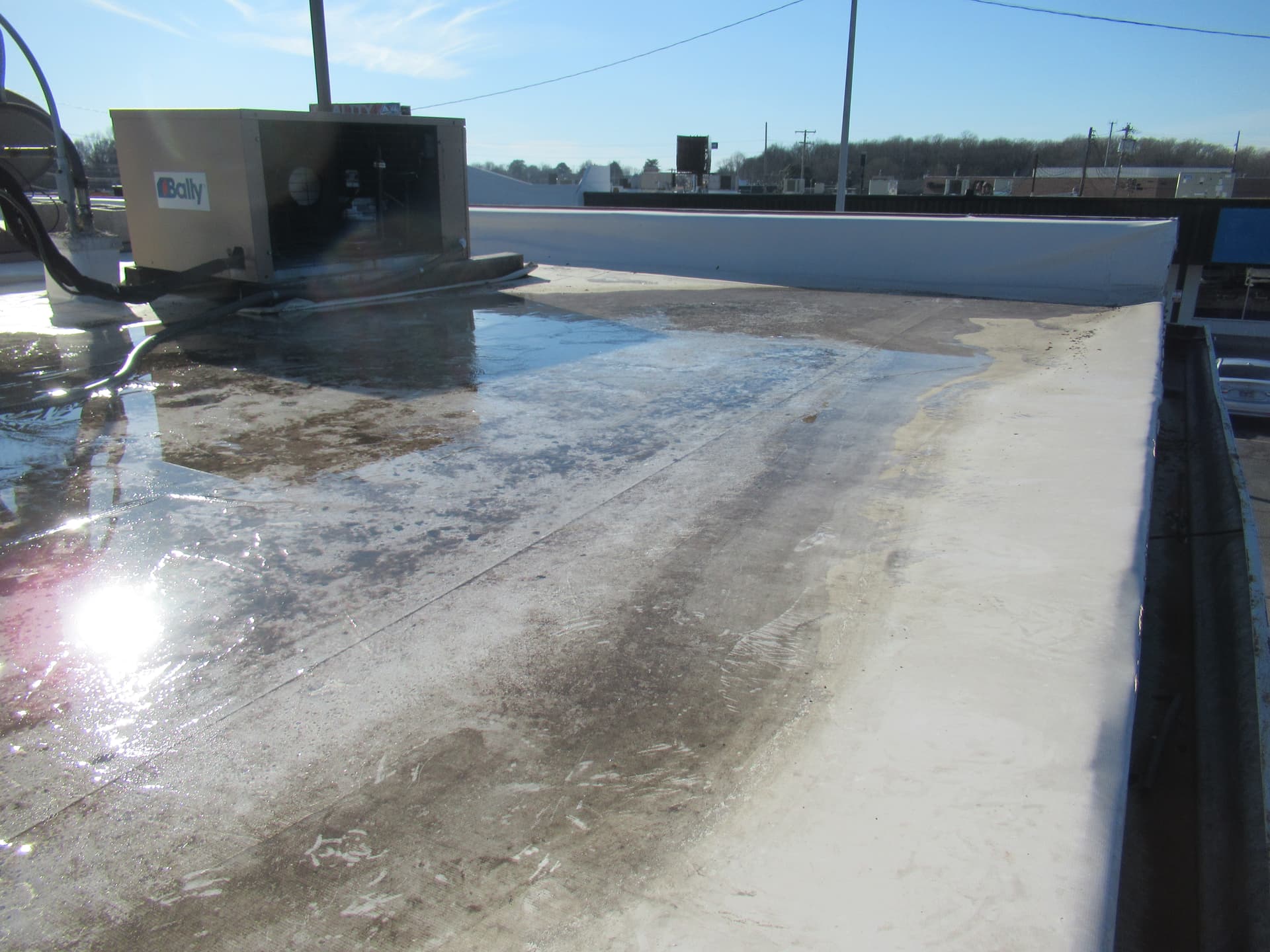

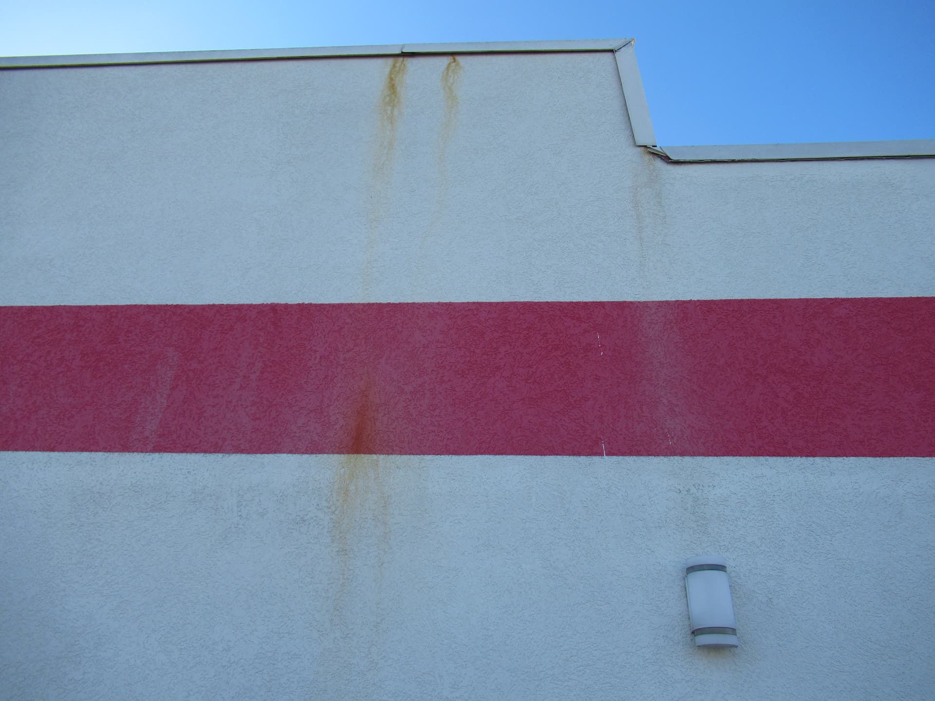

Commercial property inspected, few weeks ago. Building built circa early 1980’s in west Tennessee area. Popular fast-food chain tenant currently occupancy. Wood frame, wood trusses, plywood roof decking. Synthetic stucco. Significant concerns or deficiencies. Significant ponding water on a very newly installed TPO roof membrane. Why installed a new TPO roof membrane over areas of failed wood roof structure material that has been compromised by moisture? Significant deflection and sagging. Catastrophic? Significant long term moisture intrusion issues resulting in moisture damage at cladding, sidewalls, and interior finishes.
