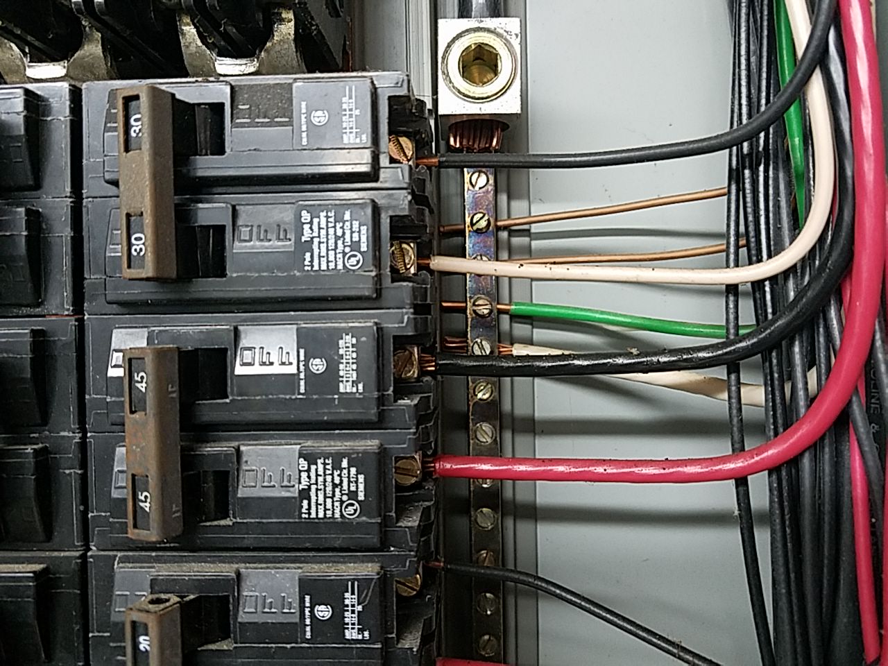

Today’s home inspection I had some discoloration on the neutral and ground bus bar. Seems like this would be caused by heat. I searched on google and through the InterNACHI electrical class and can’t find anything. The panel was located in the garage and no chemicals were found near by. I do not own an IR camera and I only used my IR Thermometer and there was no spikes in temperature. Could this be a loose connection to the bar? My camera flash did not go off and stayed the same when I moved around.
 ![IMG_20170330_102753.jpg](https://global.discourse-cdn.com/internachi/original/3X/e/7/e7938e640cb78ad587550881f0bda1b185d470f9.jpeg)
 ![IMG_20170330_102749.jpg](https://global.discourse-cdn.com/internachi/original/3X/a/6/a6212d1d5068f6695ef35f539ef144044bb30c67.jpeg)

Looks OK from the photo’s since there is no other visible signs of a problem. I’ve seen something similar on GE panels where the ungrounded lug area became discolored.
The multiple neutrals under one screw is a problem though. Each neutral requires it’s own hole in the bus.

Ok awesome, I haven’t seen that before and wanted to do some research. I am calling out the multiple neutrals on one lug.
On a similar note, should we call out the same for multiple grounds on one lug?

Many panels will accept 2 or 3 equipment grounding conductors (EGC’s) under one screw. That information should be on the labeling within the panel.
![](https://global.discourse-cdn.com/internachi/original/4X/5/f/c/5fcf159060cb6b581d8816b386625fc435a5e26b.jpeg)

Since both bars like similar I don’t think it is an issue of heating. Robert did point out the other issues.

also the white wires connected to breakers should be re-identified with red tape.

The tape or marker can be any color other than green, green with a yellow stripe or grey.
