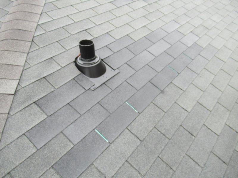

Why are we calling it out, you didn’t say why, yet.
What need to be corrected? You don’t like the looks of it, or is it leaking?
Can we “assume” that it will leak?
Good point. Is it leaking? Does it function as intended?
It functions as a pitch pocket. The point is, because it is different and never seen before in our short career, does it need fixen?
Do any of us know anything we can not see inside of?
Roof penitrations are the primary sources of leakage, but I can not assume that they are leaking because of how they look. HI Standards does not address future conditions, or how and why something needs to be corrected. Lets talk about just how this issue is a defect. Does not ripping apart a roof to correct what is not failed, more likely to cause other failures of the roof system? Is the seller expected to pay for these repairs when they just look odd? Can this application not wait till the roof is replaced, when it can be done correctly? :man_shrugging:
Simple and direct:
I observed a high-efficiency combustion exhaust pipe run up and through an existing vent for an old furnace. This is a roof flashing defect, not up to industry standards, and prone to leaks. Further evaluation and correction by a roofing professional is recommended.
all very good points imo…
That would be my plan if I was the buyer. No reason to tear into it at the moment. Change it up at the next re-roof.

When was the last time that you saw a pitch pocket that actually had pitch in it?
Not sure. I often see black pourable sealant in them, but I have never performed a lick test :smile:
The one pictured has a depression that will hold water, and the sealant is cracked/weathered. I would call it out for those reasons. I have no idea if it will last until the next replacement cycle (with or without maintenance). In my opinion, it is prone to failure. I will leave the cure up to the roofing professional.
But is prone to failure not a prediction of future failure?
