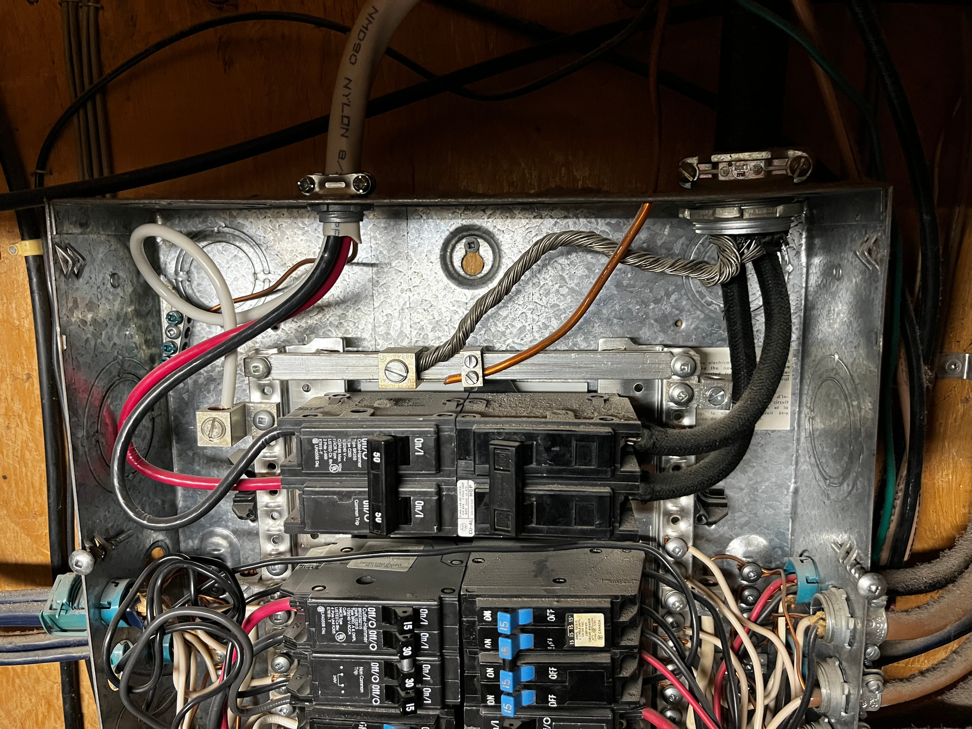

Is this a defect, since all the strands don’t fit under the screw?
 ![IMG_2137](https://global.discourse-cdn.com/internachi/original/4X/9/2/2/922cc76580342eebc14eef96571fc48258047499.jpeg)

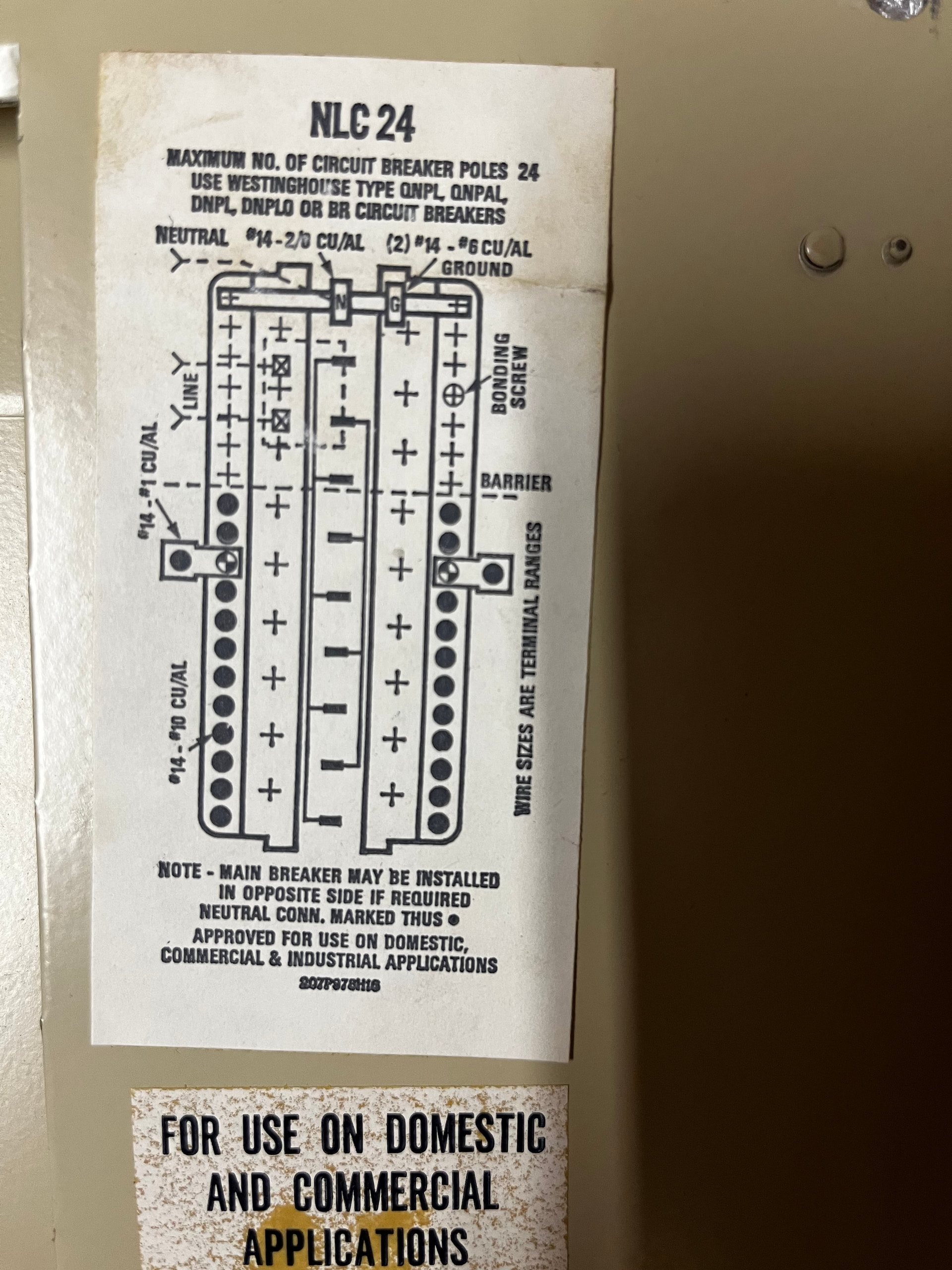

Also is this the bonding screw? Looks like it to me.
 ![IMG_2136](https://global.discourse-cdn.com/internachi/original/4X/a/4/0/a40e11966e35d2856321ec496249eb648cff8e51.jpeg)

1. yes correct that connection is no good. Also, I don’t think I’ve ever seen screws like that used to connect any wiring. Do you have a zoomed out picture?
2. No that’s just another grounding bus bar. Do you have a picture of the whole panel?

Apparently from your panel picture that is merely the ground for a 50A four wire circuit (possibly an oven). The “bonding screw” referenced in so many posts will connect (bond) the neutral to the equipment ground (often simply to the cabinet which is grounded). It may be that bond occurs above the main breaker (not visible in your picture) where the neutral and bare ground wire disappear.

Your picture is of the grounding bus bar. This does not need a bonding screw, because it is literally welded to the box. It is bonded. And it looks like there is a grounding bus on both sides of the panel that they used for all grounding conductors. It is the neutral bus bars that appear to not be bonded to the panel.

Yes it should be terminated like the white neutral conductor in the upper left of the full view photo of the panel within a proper terminal. There is actually a spare terminal on the upper right side that they could have used.
Was this the service? I see what appears to be a bare GEC in the center of the panel which may indicate that this is not a sub-panel.
