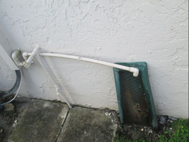

5) Let’s shift to HVAC
Inspect this!

  4. I see a condensate drain that pipes to exterior. Appears to be undermining the foundation. Drain should be moved to daylight further from foundation.

5- if the discharge piping is from a TPR valve: it should not be trapped and is of reduce size which are safety issues. Also, it appears to be leaking. It needs immediate repairs by Martin or a qualified plumber.

  5. HVAC. So, it looks like a condensate drain line, but how effective is it with the 90 degree upward turn?

5= Recommend the condensation drain pipe be routed downward and properly attached to the wall.

  5. Condensate draining near foundation, should be routed at least 12 inches from foundation wall, to avoid long term implications. Repair by a licensed HVAC technician is recommended.

  5. Air conditioning condensate line: terminates too high (should be about 6" high, too close to the foundation (should be a foot or more), 90* elbow pointed downward, in Florida will result in at least one lizard hanging out in there causing blockage.

5 Condensate line terminating at the exterior of building.Trap not serviceable.Piping should be fastened properly and directed away from the structure.

I didn’t get everything I was looking for, for the picture so it was a little hard to choose. He got the music also.
Inspect this!
HVAC condensate drain line -
Terminate no more than 6 inches from the ground
Terminates against structure, should be 12 inches away
Does not continually slope down by gravity
Not properly supported
