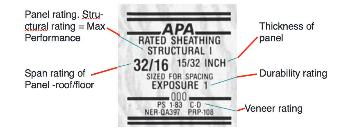

  1. Siding Face grade, span rating, Thickness, Bond Classification or Exposure durability classification, Veneer Grade.

  1. What do these numbers and letters mean? (Start upper left & go down, then upper right and go down. There are 5 items.)
