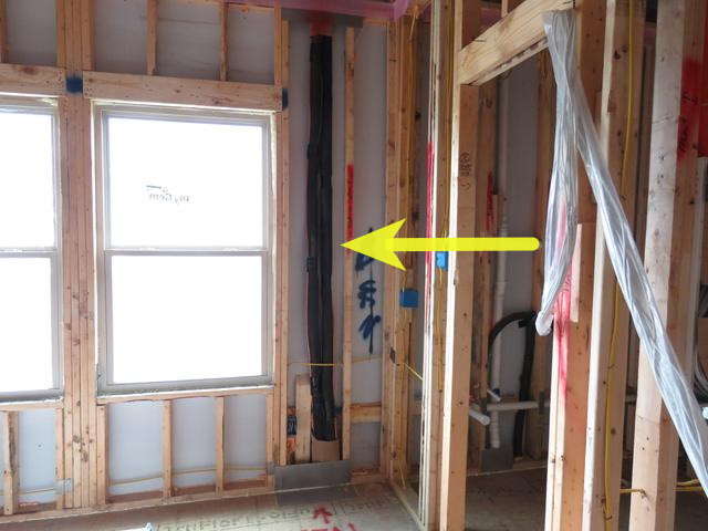

  4. The following are the particulars for this build. Given these particulars what is the problem at the stud bay pointed to by the arrow?
    • This is the second floor.
    • Walls are 2 X 4 at 16” On Center
    • The foamed lines are for two air conditioning condenser units that sit outside of the first floor wall below this.
    • Winter design temperature is 22 Degrees Fahrenheit.
    • Wind Design speed is 115 MPH for 3 Second Gust and 76 MPH Fastest Mile
    • Continuous insulation value required in external walls is R20 or R13 + R5
    • Mean Annual Temperature 64.9 Degrees Fahrenheit
    • Weathering Amount – Moderate
    • Frost Line Depth 6”

  4. the 2 AC lines are not supported, no vapor barrier (for condensation), no double insulation (for condensation), no plastic sheathing plates (for nails and screws)

  3. The slits on the foam lines are not completely taped
    Pre-insulation foam has not been injected to insure an air-tight chase between floors (fire-stop, draft stop, and moisture barrier)

As a home inspector, we would look for visible signs of moisture intrusion and associated issues (mold, rot, etc.). Knowing the potential for air leaks in a chase that goes between floors, and the associated building science of air movement between the two floors, would focus our attention to examining the bay with extra scrutiny in that area…
