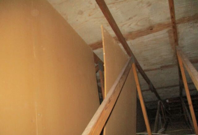

3) Inspect the image

  3. Fire separation material is loose, resulting in a break in the fire separation barrier.

3 Inspect - The separation wall in the attic appears damaged. A panel is displaced so the fire barrier is broken. Fire separation walls should be made from materials with at least a 1-hour fire rating, typically 5/8" Type-X drywall. The wall panel pictured appears to be MDF which may or may not be fire-rated. No markings on the edge are visible to indicate a fire rating so this may be standard MDF.
attic firewall open
