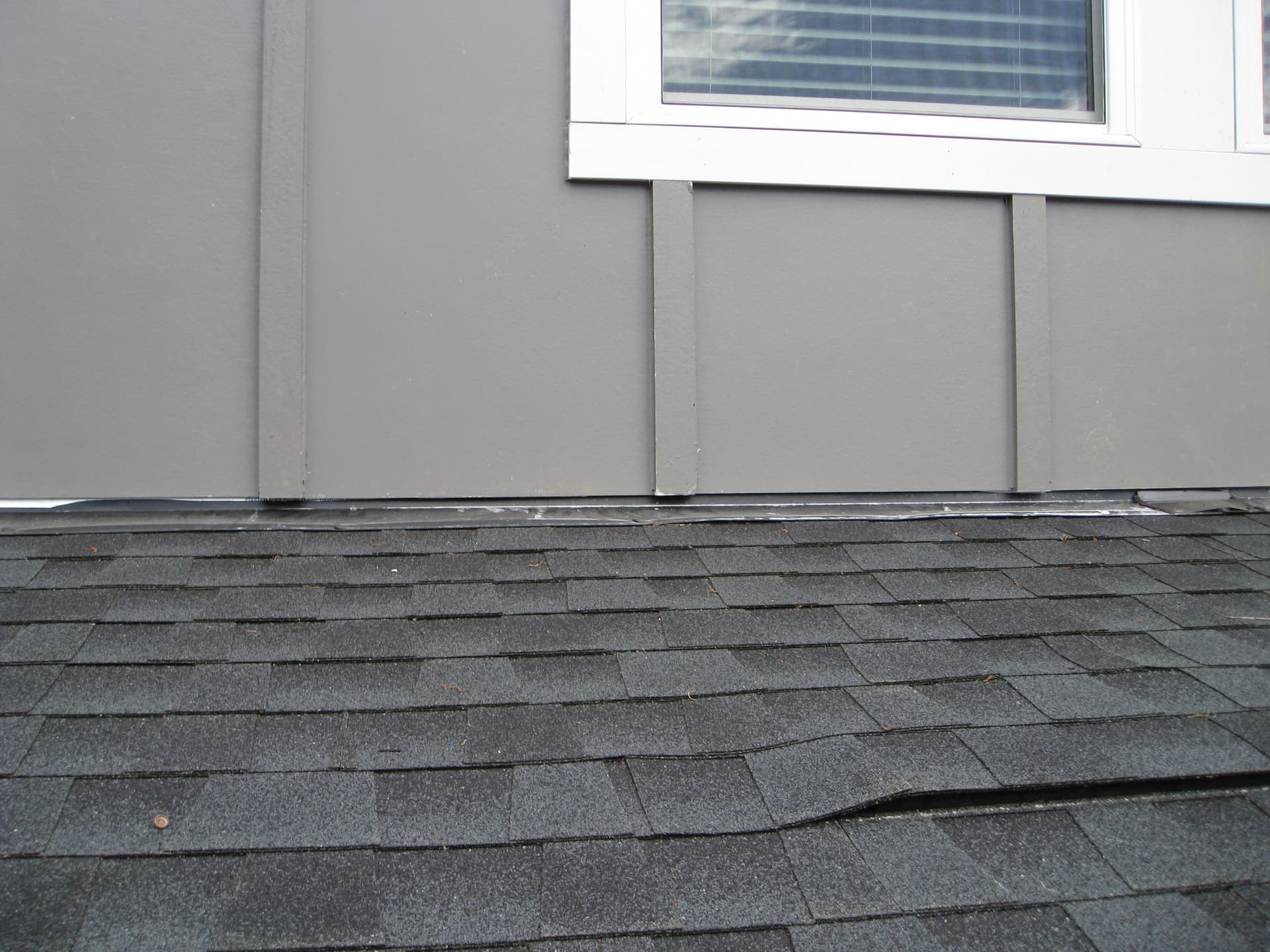

Notice all the fasteners are exposed (see the red circles) in the header flashing. Is this allowed in the new house roofing practice, or it is a defect? (all the neighborhood are built in this way)
Another question: is the kick out flashing too short, as circled in the following photo? Its dump is flushed with the stone siding beneath it. I think it will not efficiently guide water to flow to the gutter. What do you think? Also, the sheathing is visible from ground, I think the local water splashing is going to damage the sheathing. is this an issue as well?
If they insist on using fasteners here, it would be best if they were covered with sealant.

From that view, I would definitely like to see that kickout protrude further. During heavy rains with a lot of water flow, it will be ok but lighter rains I don’t think that water is making it to the gutter.

I agree with Ryan and Scott. The vent is fine, the kick out is not. It should be turned-in to direct the water into gutter.

Although the kick out would be nice to divert into the gutter, it is not required… the only function of the kick out is to keep water from entering behind the wall material.
I wouldn’t call it out, because I dont think anyone would do anything about it.
If it was directly over a walkway than I may mention it as a nuisance.
I’ve seen those vents in both Oregon and Maui as well. A roofer I know calls them “eyebrow vents”. Not sure it that’s correct/accurate. I personally think they look TERRIBLE and wouldn’t want them on my house or my neighbor’s. Function-wise they do help get the air intake above the insulation line in the attic which is often a struggle as we all know.
As for the downspout/kick-out debate, I think the kick-out is fine but the gutter is too short. The upper downspout discharging right against the siding roof (step-flashing) seam is not ideal. Of course, gutter guys aren’t building envelope specialists so they rarely put any thought into it. As for the fasteners on the head-flashing, I see them like that all the time and they are either sealed over or have rubber/foam washers.
