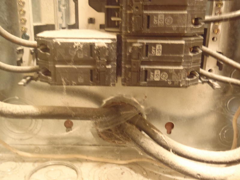

Had a service disconnect outside that only used load wires and no neutral. The ground was in the meter base.
Inside was a standard panel with additional service disconnect and they wired it with isolated grounds/neutrals and removed the bonding bar at the bottom.
Whats the best way to remedy this one? I figured just re-bond both busses should correct, and the original disconnect would be irrelevent.
This service needs to be done over. :roll:
The grounded conductor is required to be brought to the service disconnecting means. Also you cannot have the service entrance conductors and the feeder conductors in the same raceway. There also appears to be some other defects but it’s hard to tell from the photo’s.

What’s the contaminate that’s all over everything?
(hint-hint). :wink:

And yes that nipple is indeed a service raceway. I’m not sure how this passed an electrical inspection in the first place.
The installation also violated this:
With out a neutral or a ground on the service disconnect, the person throwing the disconnect could easily become the neutral or the ground for the service disconnect.
The really was 2 disconnects. The primary one outside was nothing more than a place to connect the two sets of wires.
The neutral ran into the inside panel but they wired it for a sub instead of a main. So isolated grounds with no way back to neutral. I would think adding the bar or jumper back in place would resolve the issue.

You would have to get rid of the outside disconnect before your idea would work.
Yep.

As an electrician it needs to be replaced.
From the outside breaker to the inside panel needs to be 4 conductor

Looks like a metallic raceway in photo #3.
From the meter to the service disconnect requires the installation of the grounded neutral conductor. From the service disconnect to the inside panel requires the installation from the service disconnect a grounded neutral conductor that has been bonded to the service disconnect.
What is pictured as best as I can tell is the grounded neutral leaves the meter base and enters the inside panel without going to the service disconnect.
