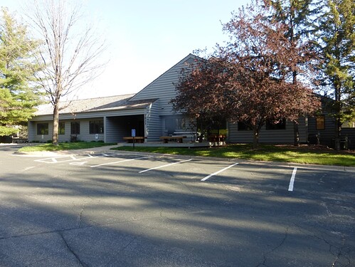

> [@ruecker](#):
> Being able to do 41 tests simultaneously
Absolutely the way to go. I did a 35K SF office building about 7 years ago, which had a full basement with offices, meeting rooms, and the mechanical rooms. One end of the building was built into a hillside, and so they requested Radon testing. I used a total of 21 test kits. Took me about an hour to set all the tests and fill in the locations on the COC forms (see my post above). Returned three days later on the day of inspection, packaged everything up, and drove one mile to ship them out USPS priority mail. Had my results back in two days… before I had completed the inspection report!
 ![P1010385](https://global.discourse-cdn.com/internachi/original/4X/8/f/0/8f05a3f1a22d264c318d7613c43ce10c5426cecb.jpeg)
 ![P1010487](https://global.discourse-cdn.com/internachi/original/4X/b/1/6/b16e7560a8442cb1eb06728c05e0f76176a79476.jpeg)
