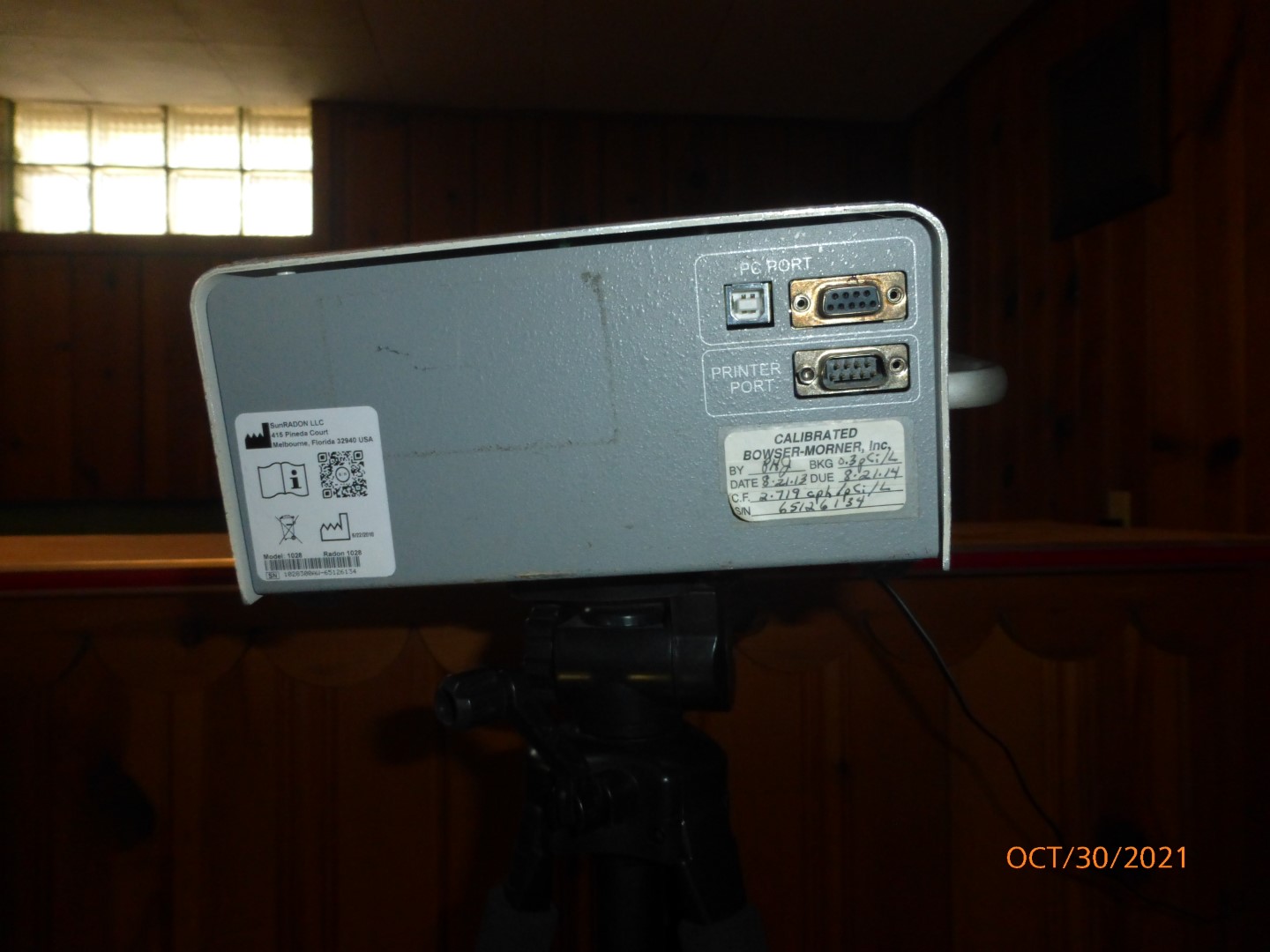

I can’t tell you how often I walk into a home when a Radon test is in progress. I ALWAYS take a photo of the test and the CRM’s Info plate/sticker. I would say at least 25% of the time the calibration is expired, by usually about 1-2 years. I actually found one expired by about 7 years!!
Ironically, I looked up the testing companies name on the State website, and he actually lived across the street. I was so tempted to walk over there and “inquire” wtf he was doing charging my client for his crap CRM. I really wanted to turn his ass in to the Sate! (Yes, he had a valid license)!!
Note: I did include a photo of the Data plate in my report for my client to do as they pleased with the info.
 ![P1170360](https://global.discourse-cdn.com/internachi/original/4X/c/e/b/cebd88280522b2f78cdd15fd7cb2dae5d97ec0f8.jpeg)
