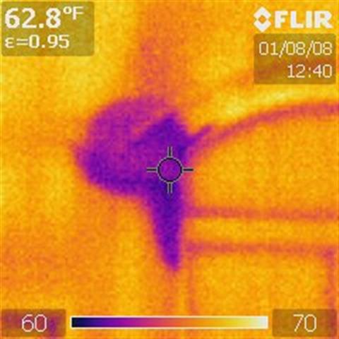

My point is that thermal imaging is a great way to cover ones butt and see things that they would not normally see (because they were not naked eye visual at the time of the inspection).
The same thing is true with Jeff’s example. Do you want to get the call back, in a month or two after the buyer’s move in, and try to explain to them how you missed that leak around the window or in the skylight?
I just love the camera’s ability to check skylights. These (above) pictures were from a new construction condo. No visual evidence of water intrusion, but I saw this with the camera, git out my ladder and checked with the Protimeter, and, sure enough, it was wet. Bad flashing. The builder was there and was very impressed. he told the client that this find, alone, was worth the cost of the inspection :smiley: .

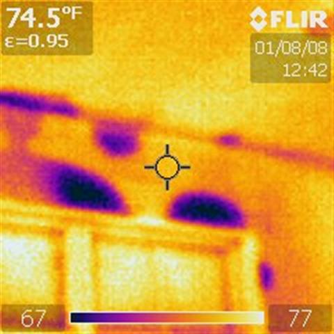

Rain in Decker Territory:
New construction. Builder loved the IR demo I gave him on his own home.:wink:

Didn’t tape the windows and had Polish bricklayers and that “trim” stone strip above the windows wasn’t properly flashed.
People have to learn that with bricj veneer, such stone trim has to be specifically flashed. Such details are normally found on masonry structure walls, but added and specially installed.
These “old world” masons try for the same effect on brick veneer walls, with this result. They don’t realize how the inter wall space works and take the detail stone all the way back to the house wrap. This is the result.
This is what happens when “old world” craftsmen (and very good at what they do. No slam to Polish people or these workers intended.) and “new world” construction techniques (like wood framing with brick and stone veneer) collide and the lack of continuing education requirements for many of the “licensed” trades.
CORRECTION: Talked to Linus and I missed something. He said that the first thermal image was taken fron the interior if the 2nd floor. I didn’t see (stupid me!) that the dormer over the 2nd floor window was not flashed.
I stand corrected. The 2nd thermal image meets my description. The first is just lack of dormer completion.

Will, did you confirm the exception in purple with a moisture meter?
