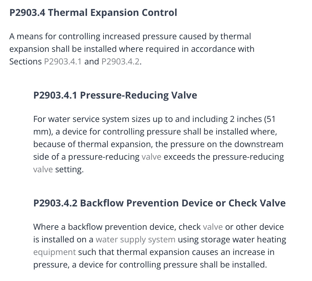

What do you base this on? a device to control thermal expansion is required by IRC 2018 adopted by state of Florida (when it’s a closed system). I doubt your AHJ overrides these requirements. Of course this does not apply to old houses, however, a plumber with a brain will always install one because, for example, a lack of thermal expansion control device will defeat the purpose of a pressure reducing valve. Even though the code (which is minimum) only requires a pressure reducing valve when pressure exceeds 80 PSI, as you saw, AOS recommends it even when the pressure exceeds 60-65PSI, lower than the code.
If a pressure reducing, a check or a backflow prevention device is installed, it is required, this is from your state’s code:
As far as a vacuum breaker, I only know of one state, Massachusetts, where it is required, regardless if it’s a hybrid or regular WH.
Because down here, nobody installs a closed system. From water meter, to shut off, to home. And water pressure is consistently between 40-65 psi
