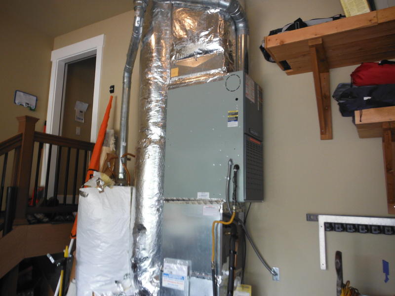

Vent pipe for furnace in contact with combustibles

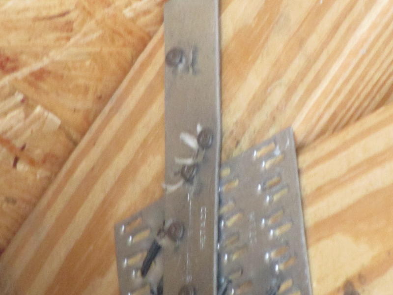

As required for Wind Mitigation for Insurance Rate purposes, the follwing is a typical Hurricane strap for the Miami Dade High Velocity Building Code which has been adopted by nearly all coastal zone states.

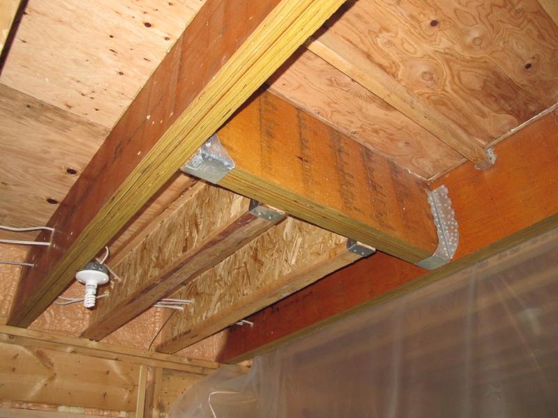

Attached is a photo of doubled 14" LVL floor joists supporting an opening for stairs with 14" wood trusjoists on a 20’ span.
For the Residential Structural Design course inspection, I examined the main floor of a newly constructed addition and found:
Slab on grade foundation with 6" CMU, core filled, attached ~6’ with 1/2" anchor L bolts
2x6 on 16" studs, double trimmers on >4’ openings, 2x10 triple headers
1/2" spruce exterior plywood sheathing
14" TrusJoist engineered floor joists for 20’ span, doubled 14" LVLs for stairway opening
Adequate fastening throughout
No defects other than the stairs have not yet been constructed.
