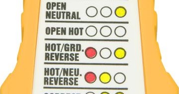

Wouldn’t a hot ground reverse be just as dangerous?
 ![IMG_0065.jpg](https://global.discourse-cdn.com/internachi/original/3X/5/3/53ae21ce4fe8cef380a0f5fbf027d3582828c59e.jpeg)
<div class="post-metadata">
**Post date:** [September 13, 2012, 7:01am UTC](https://forum.nachi.org/t/reverse-polarity-bootleg-ground-and-3-light-testers/71655/12 "2012-09-13T07:01:52Z")
</div>
Yep worked on my last inspect.
Thanks again.
