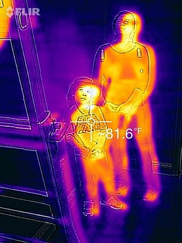

Flir One
 ![thermal garage wall](https://global.discourse-cdn.com/internachi/original/3X/f/7/f7d2f3b03457d75f6227e0292e8efa97025d6436.jpeg)
 ![Veronica & Son Thermal](https://global.discourse-cdn.com/internachi/original/3X/c/1/c16a761eaa57c8482c83c46dd4030c2f7a638b22.jpeg)

Note how with the Flir the IR resolution is actually quite low,
the magic is in the black and white image and the edge detection done in software. The net effect is quite good.
In different, non-inspection work I do, the IR resolution is more important, and the Seek beats the Flir there.

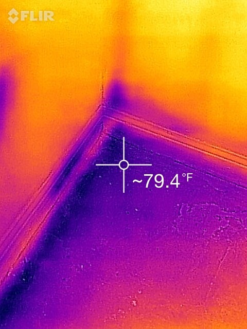

I bought a Flir One Pro a couple of months ago mainly for my own home testing and just to get familiar with IR cameras. I have used it on many inspections just as an extra tool in my tool bag for checking heating registers, GFCI receptacles, electrical panels and just to see what I can see. Not doing full blown IR thermography but I think this can be a good tool for just about anybody. The images are easy to see, include background details, and for the price, around $400, I think it’s worth it.
I’ve read some negative reviews about the software and battery life (around 45 minutes - who needs more than that?) but so far no problems with either. There is a big difference in image quality between the “pro model” and the others so definately go for the pro.
First is my dog - nose is cold, good boy!
Next image is a heated garage floor for a friend. We were trying to decide where the heating loops were and didn’t want to drill any holes where the loops were. It was easily apparent which areas of the floor were heated.
Other images are from under a kitchen sink and you can see that the heat for the register below the bottom of the cabinet is pouring into the cabinet. In the normal pic you can see that the base of the cabinet is severely deteriorated and the heat is going through the base.

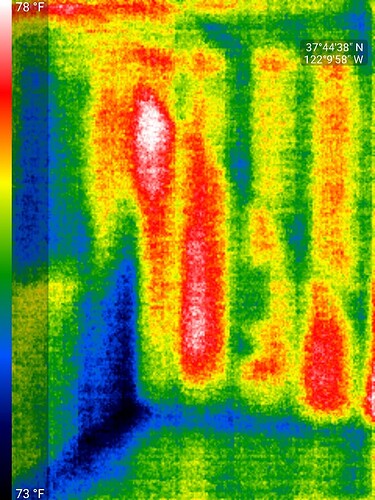

So what are you seeing that I’m not? One image is yours (top) and one is a FLIR (bottom).
![image](https://global.discourse-cdn.com/internachi/original/3X/0/9/095cdbe51edd87d11a25d8aef2b5f63de6b055be.jpeg)
 ![thermal](https://global.discourse-cdn.com/internachi/original/3X/a/e/ae8b8f59b2872f869788ea1a93fa088cbc751835.jpeg)
<div class="post-metadata">
**Author:** ![bnesbitt](https://sea2.discourse-cdn.com/internachi/user_avatar/forum.nachi.org/bnesbitt/32/56701_2.png) [@bnesbitt](https://forum.nachi.org/u/bnesbitt)\
**Post date:** [December 10, 2021, 3:01pm UTC](https://forum.nachi.org/t/review-of-seek-compact-xr-pro-thermal-camera/205244/18 "2021-12-10T15:01:00Z")
</div>
> [@mwilles](#):
> > [@bnesbitt](#):
The Flir merges a visible light photo, with a smoothed version of the IR sensor.
The SEEK is just raw pixels. But there are more of them per the specifications.
I purchased my SEEK for inspecting electronic circuits, not home inspections, and the extra resolution is very helpful when inspecting tiny things a few millimeters in size.
I’m still happy with the seek in that it’s so small I can carry it in my bag all the time (e.g. when I bicycle to a job, and only bring basic tools).
